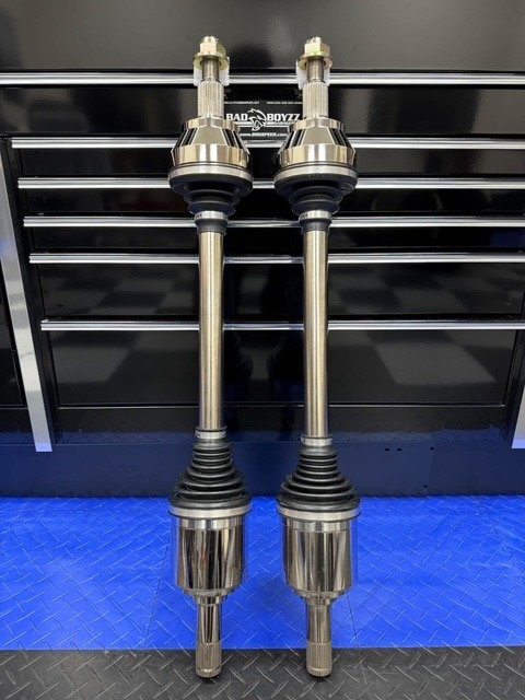

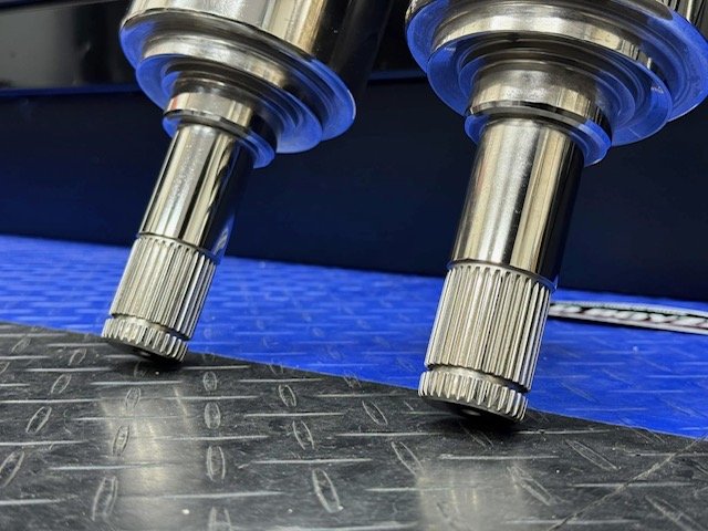

Do they come with tone rings??
Not currently, however we do have reluctor tone rings in hand and may be offering as an optional component separately to HellCat nation

These , they supposedly warranty them for any type of breakage, not like DSS or GForce
Yes, Lifetime Warranty🇺🇸 on CV’s and Axles except on boots! Warranty needs to be done through your selling dealer or BBG direct.

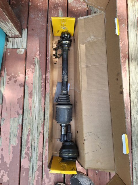

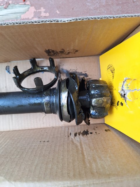

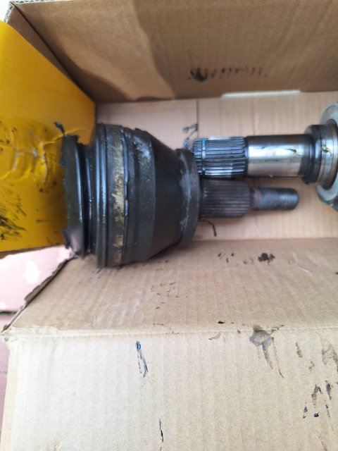

Picked up a vibration during sick summer.. then promptly Chucked the driver's side on the way home during a pull. Outer CV exited the chat in epic fashion. Never found all the internals. Looks like it sheared right off at the base of the cup? Also...diff splines were starting to twist. Days were numbered regardless.
51k miles. 42k modified. Hundreds of hits. It owes me nothing.
Redeye?
DSS?
GForce?
BadBoyz?
Car is not lowered and never will be. I do not autocross. Drag racing and Drag & Drive only. Lots of miles. Lots of launches. Great to absolutely Excellent prep.
F for the stockers. You will be missed. Thank you for your service.

Give us an opportunity Sir🔥we’ve captured the attention of some serious builders. We’re not looking to compete, looking to be another solid option for the HellCat Nation!
Made in the USA🇺🇸
BBGSPEED Tech Line
(916)505-9026
