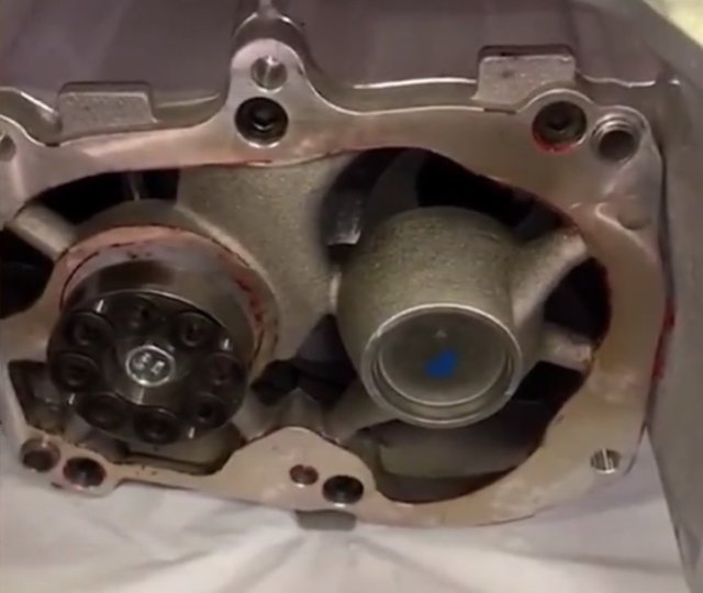

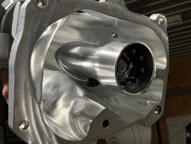

Here’s a picture of 2.7 snout and bearing plate that I got from Brett @Jokers
07F910A0-58E0-4D73-8E3F-19B101A08B4B.jpeg BB151C53-92AA-4B75-B0C5-1BF346B19475.jpeg
