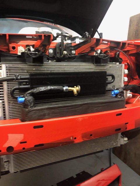

Ummm. I’ll just say this..... I didn’t cut the front bumper crash bar. Simply mounted the brick to the underside using the included brackets. I know... it blocks some of the lower radiator. Makes no difference. Driving the car around in 100++ degree heat in Phoenix with no rise in engine coolant temps. I know what the instructions say. Men never follow instructions. Ask my wife. 69514F96-7EC4-4125-973A-F31BC72A3FEA.jpeg
Loucifer
Loucifer
#1117
21
Chandler
17 Challenger Hellcat
Ummm. I’ll just say this..... I didn’t cut the front bumper crash bar. Simply mounted the brick to the underside using the included brackets. I know... it blocks some of the lower radiator. Makes no difference. Driving the car around in 100++ degree heat in Phoenix with no rise in engine coolant temps. I know what the instructions say. Men never follow instructions. Ask my wife. View attachment 3939
Nice. This is a reply I can ponder on...

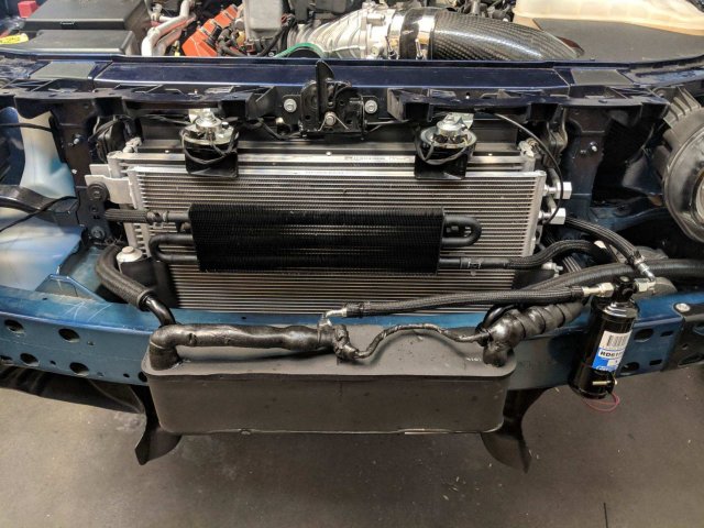

Our Active Interchiller 19" Competition Xtreme Chiller can be mounted by cutting only halfway through the crash bar and retaining one of the 2 boxes, this can not be seen and does not block any airflow. Or you could do our 13" Vertical Chiller that is very efficient and is 100% bolt-on under L headlight by removing the small aux. HX. We will be a Vendor on here as soon as its setup, so there will be full information. We will also have a Hellcat Demonstrate our 19" Interchiller at FL2k Sunday morning 10/13

The amount of Freon you would have to use to install this in your trunk would be extremely costly. Many ways to mount this to the front without cutting anything up.
The picture above is not a FI Interchiller. that is another company's product. I have a FI Interchiller on my car and would only buy a FI Inerchiller. The FI Interchiller is made in Australia not the US. PM me if you have any questions.

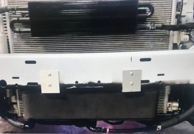

Blkout
#1095
852
1,383
Warner Robins
FI Interchiller Stage 1 mounted on my car.
