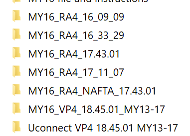

Well as it turns out, I am NOT current, I don't recall my exact reason for discontinuing the updates, it may have in fact been this issue, I think it was also related to unsubstantiated reports of the update associated with the original exhaust cat recall/update that some said robbed power.
But, at least for the moment, my gauges are correct/matching between the radio and the driver's display.
Ref: currently running 17.11.07
(Known releases in my archive)
