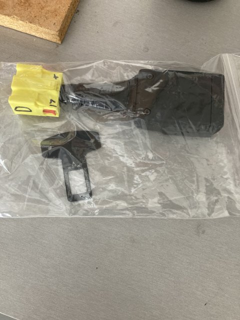

In the one Pic you can see the Airbag Light Bypass Harnesses I made for Dan. One is for the Pass side. The other is for the drivers side and that is the one with the small grey connector. If you buy the seat belt Buckle number I listed, it will plug right into this device and then the seat belt light will function like Stock OEM. I call this the divorced setup and I prefer this on my own car.

Ron; tell me more about the air bag bypass harness, I bought a buckle for the drivers side of my demon a few months back from you that was supposed to be all I needed, it does not have the small grey connector, it’s a buckle with a large yellow connector,

Here’s a picture of the harness. So this only takes care of the air bag light and not the seat belt light?

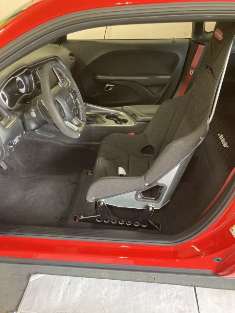

i finished up my seat install today. I took the brackets over to my friends house yesterday, he has a drill press and a band saw, it took us about an hour and a half to make all the cuts and drill the holes. The install went well following Ron’s instructions. My seat wobbled a little as well sitting on the work bench but once it was all bolted down it was fine. Weight savings about 48 pounds! Can’t wait to see how fast the car goes now. Thanks again Ron.
