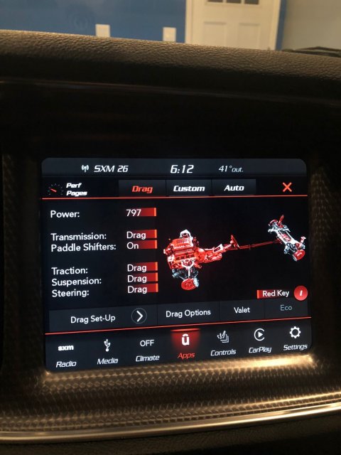

We are happy to announce that our HO upgrade for 2018 and up Challenger both Hellcat and Redeye. Our Kit includes the Following
1) Custom HO Enabled Unlocked PCM-Diablo or HP Tuners Compatible
2) Custom Programmed BCM to match your cars options
3) Hemituner Edition Tazer with custom Button Mapping
4) Hemituner Gateway Bypass Cable
Price for the Kit with a New PCM is $1999 or for $1599 you can send your PCM in and we will install our programming. Price includes Shipping in the US. All PCM's include our HO calibration with custom mapping for 100 Octane on an otherwise stock engine. Custom tuning packages are also available, Please PM or Email us with any questions. Demon Center Stacks are available for an additional charge.
Thanks
AJ

Need some help understanding. For this conversion on a Redeye the HO mode is same as the Demon 840 HP? What about with the Litens 3.17 pulley?
H
Hemituner
#1284
82
242
Bayshore
2018 Demon
The HO mode package will boost the Redeye to 840 in HO mode without a pulley change
Thanks
AJ

Tim Barth mentioned the litens 3.17 pulley with this as an additional option no tune required. Do you know if the 3.17 pulley would be okay on pump 92?
7,631
19,980
No love for MY15-17
I don't think it's compatible :( FCA changed the computer setup in these cars in 2018.

@Hemituner
Yea it would be fine , I just did this to my 2019 redeye .

This is a great deal I'm enjoying mine have not put race gas in it as of yet but did a hit in drag mode and its definatly all that and then some.
4,873
25,943
