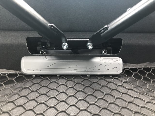

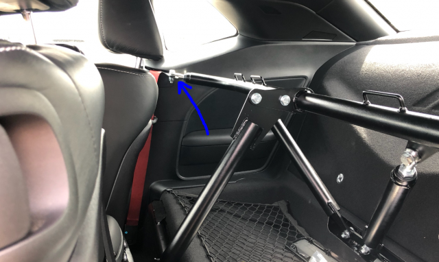

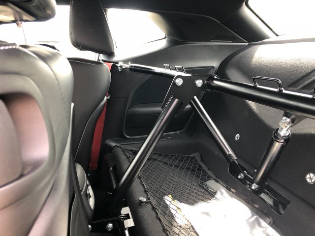

Hi,
I just got the harness bar installed in my Redeye. I need to cut a slot in the grey trim plate for the rear lower harness bar plate to come through the center of it. Does anyone have any good ideas to make a nice slot while keeping things straight. Was thinking of a little cut off wheel on my dremel and following a trace line. Than clean any edges with a file.
AAD Performance, the makers of the bar have been great. They told me if I swung their way sometime, the would measure and laser cut it out for me. Thats an option as well. They are a couple hundred miles from me. But Parker said he would fix me up! The harness bar is top notch and was packaged very well in very nice foam.

Cutoff wheel...then the file...take your time...that's what I did with mine on my Demon...remember...take your time...

I flipped mine over.
I used a razor blade knife.
Took about three passes.
Clean as whistle.

Thank you! I will have to do that. As this piece cant be bought separate. It only comes with the rear seat delete as a unit. Thanks for the advice!

Maybe have someone or yourself custom make an additional cover or leave it off? I’d save that rear seat delete cover and not modify it. Just in case you decide to take the harness bar out? For me I have a back seat so not worried about the cover. I leave that bracket on between the seats so I can quickly install the bar.

I like the idea of not modifying the cover since it can't be bought separately. Get someone to plastic print one for you that's proper. Can get a template from cardboard.

Harness bar looks good & yeah , just leave the plastic piece off , it looks fine like that , if the bar comes out then you can pop it back in.

You know what, that is a very good thought. Actually Parkers partner at AAD told me they could also possibly make me something at one time when I talked to him. I may go that route as well. Heck, a piece of low cut carpet cut out and sized right may look great as well. Put some stiffening cardboard on the back or thin plastic or even aluminum to stiffen it and glue the carpet to shaped plate.

Actually the side panels (stock seat belt mounts) is not bad at all...just carefully pry them back a bit...no need for disassembling...you will have plenty of room...actually when installing the bar..an extra set of hands comes in handy..the whole install was easier than expected
