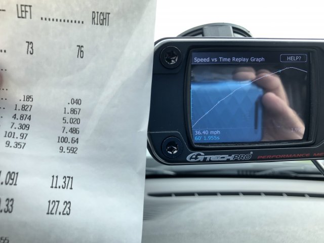

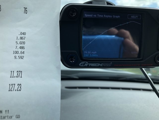

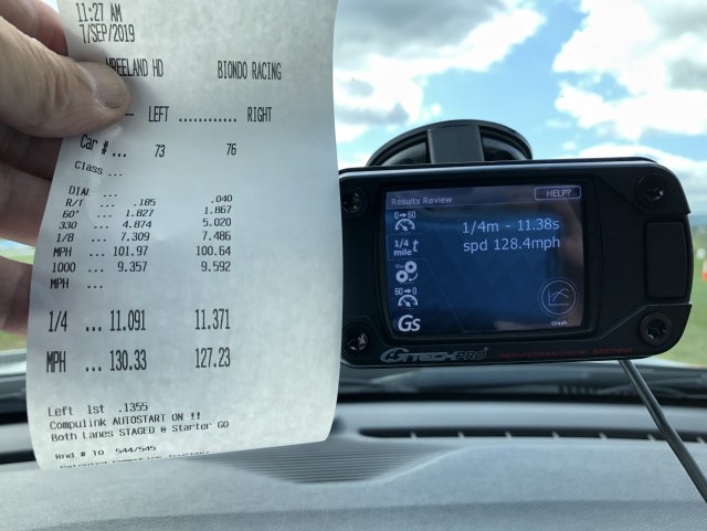

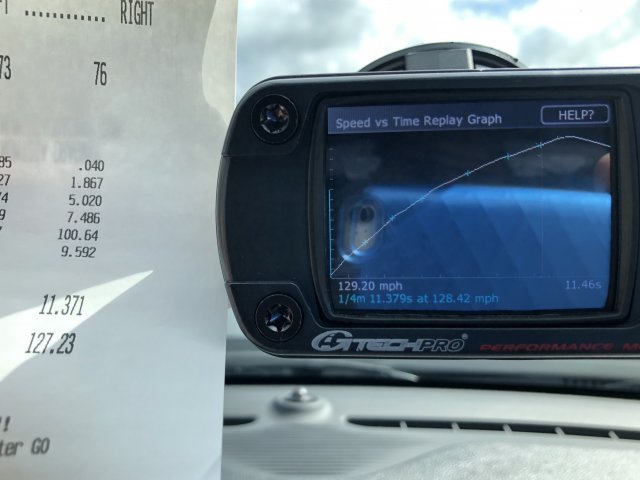

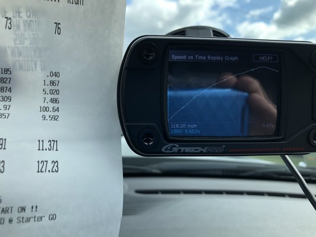

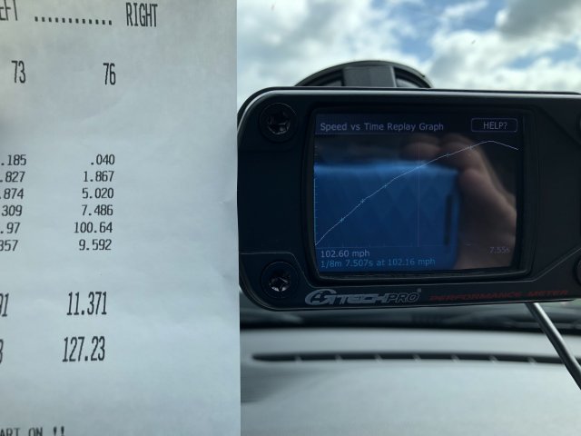

I’ve used various GTech GPS based timers for years, their latest 50hz unit claimed to be accurate to 1 hundredth with good satellite reception. Many have argued with me their way off etc etc only track tickets count eye etc Here’s proof they are accurate, damn accurate. I used it on every one of 19 runs and all like this or better, this the only run I took the time to take comparison pictures of. I recommend them for practice, they work. The 0-60, G Force and HP and Tq functions almost balls on to.

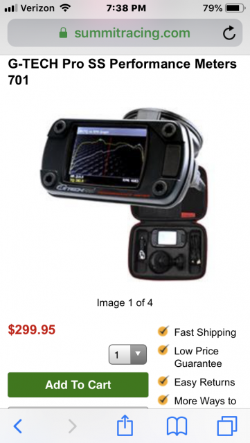

That's really accurate. What does something like that cost?
3,688
8,702
There are 2versions
The SS version which I have is 299, it is mainly for 1/4 mile straight line use
And the RR model for 399 which will do straight line timing and also via GPS automatically map a road race type track you are running where it will tell you lap times but also times through turns and whatever portions of the track you want and let you know where you are slow, fast, G’s through turns etc to help you run the course better.
