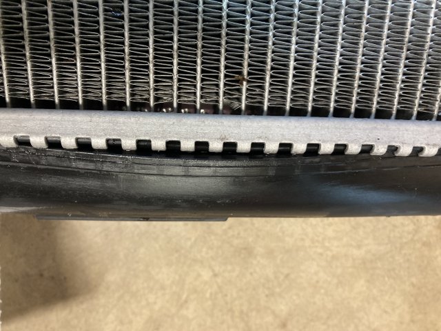

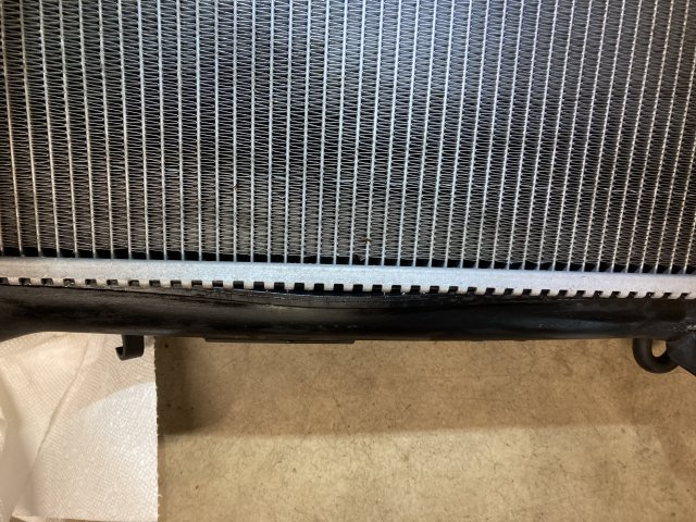

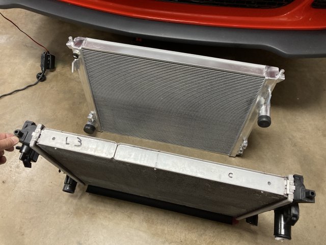

Mine did the same thing, could not find the leak, it found me top of a 1/4 run, luckily it let loose when I let off it it could have been bad. Tank separated from the radiator about 6-8” long and emptied it in about 10 seconds. Check the sides of the tank for signs it’s being pushed out from under the crimps.
3,635
8,546
This is what to look for, Replaced it with a all welded together 100% aluminum Misimoto one.

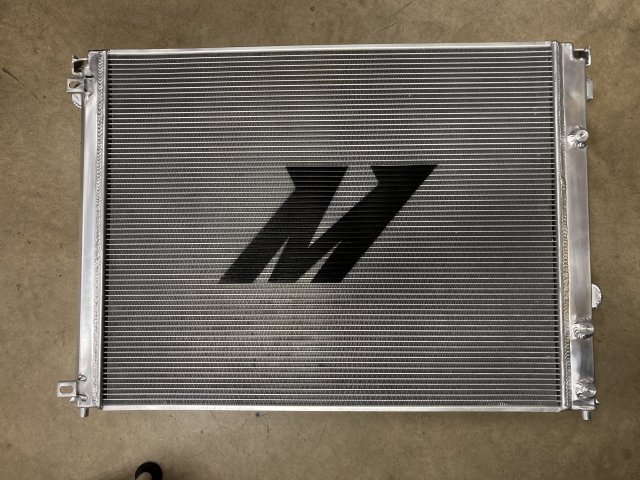

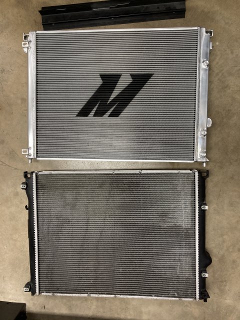

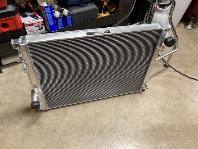

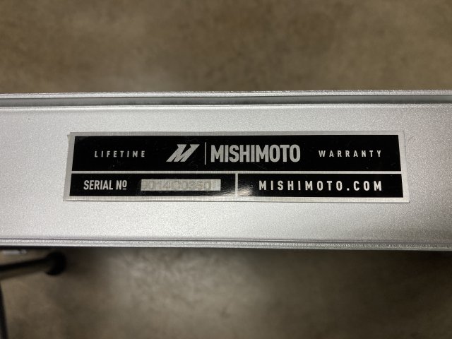

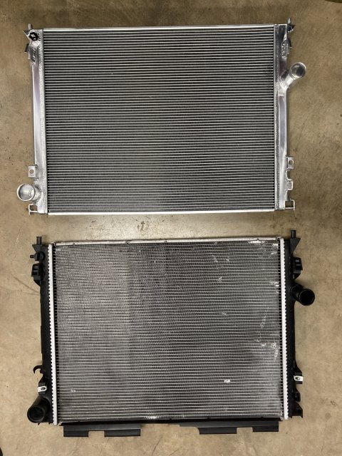

Like this, pricey but works excellent, keeps up with the cooling needs of 1100 wheel no problem, and gives peace of mind it won’t happen again. Well worth the price, direct no hassles bolt in.

Changed myself, it comes right out the bottom, not that hard. No, the whole facia does not have to come off lol. I posted pictures of how to do it somewhere.

Just throwing out there that I would be considering/shopping the Ron Davis custom aluminum Hellcat radiator all day long vs Mishimoto...
U.S. company vs "other"?
1,491
3,740
yep, plus they made my custom engine/trans unit for my dragster that gave me 16 yrs of trouble-free service when I sold out a few years ago, plus, they happen to be right down the street from me ;-)
