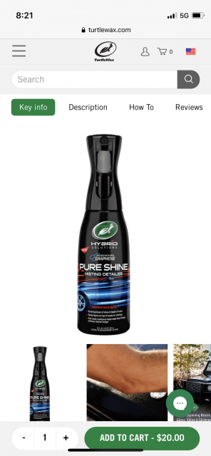

So if ur gonna do all that work then just buy some ceramic coat and apply it vs the wax. I can actually get my car to shine better with Turtle wax Graphene that I can with a ceramic coat alone but it just doesnt last long OR u could apply the graphene wax over the ceramic coat after it dries to make the car pop even better.

This makes the color pop
smell is delicious
