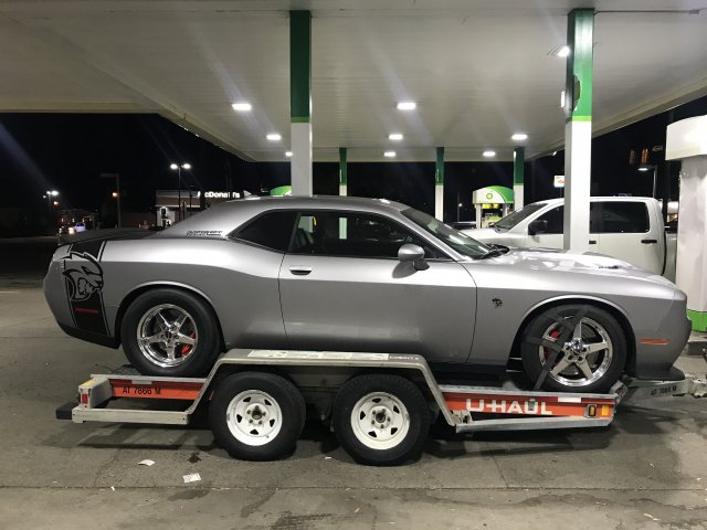

I’m loading mine up on a uhaul car hauler lol, the wheel covers in the hauler fold down so it’s easy getting in and out E6EFB0CB-FDA4-437D-9B8D-B04F050895CA.jpeg

hellno - I saw a NB Challenger at Beech Bend 2 wks ago on one of those trailers. It looked like it was using up most of the room. I'm pretty sure my rear tires would rub the outer rails.

Just go to a u haul and measure it

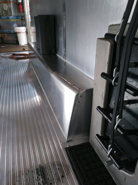

If you have skinnies on the front that makes it easier. I usually park my car in line with the ramp or trailer and then get out and go back and site down both sides of the car to see how aligned it is before even attempting to load it. If you are out of whack you pay for it down the line.......My back tires do come up into the wheel wells because my trailer has a spread axle and it is only 20' long. With the 315's I only have about 2" total to deal with. I notched and layed over the corner of the fixed fender on the right so if I do hit it , then it will not cut down the tire right off the bat. I did hit it once. Left fender is removable.
I would not pull that emergency release in the console if I did not have to. On my Hellcat it broke the clip right off the bat and then it would not lock in the home position after that. If you do, then pay attention and do not force anything. Easier said than done because you kind of do have to force it. Why not have the window down and then let it idle in nuetral while you load and then reach in and put it in park and turn it off.

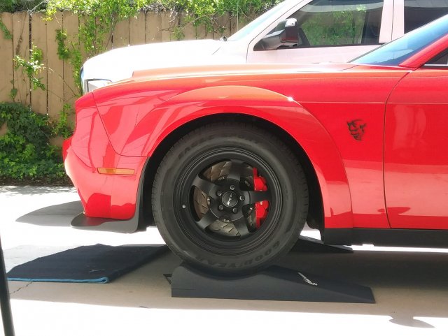

I put my car on 3" ramps in the front to be able to reach under the splitter and hook the tie downs on it. 2x12's work also. 0418191401.jpg
