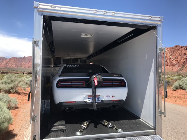

We can, and I have the sleeves, lasso loops and/or axle straps to do it. Just never used them.
What I don't like about that method is that no matter how nice and fuzzy the sleeve is, it can't be good for the paint. With chrome wheels I probably wouldn't mind.
But maybe more importantly, while that setup works in the rear where the wheels are locked, I'm not sure I'd trust it in the front. Since the loop will have to go close to six o' clock (to clear the splitter), there's a definite possibility that the tire and wheel can turn (overcome the friction of the tire), which would loosen everything.
Granted, it's the rear tie downs that are most important, but still. I'd like my 'Cat to stay put even when/if my trailer ends up on its side or roof.

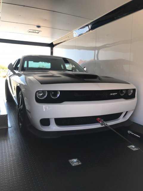

I'm a firm believer in using wheel nets, and very anti tying to sprung parts. That basically means E-track under the tires.
Having tied down all kinds of vehicles over the years, a Challenger presents different challenges than what I'm used to, with the low clearance in the front, especially.
Pulling down on sprung parts is bad but pulling back and pulling forward just locks everything in place. Even if I used wheel nets I would still feel better adding a strap front and back just in case.

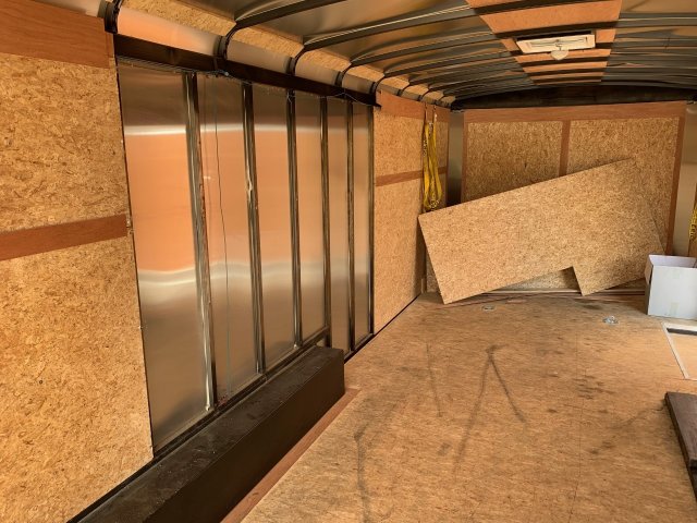

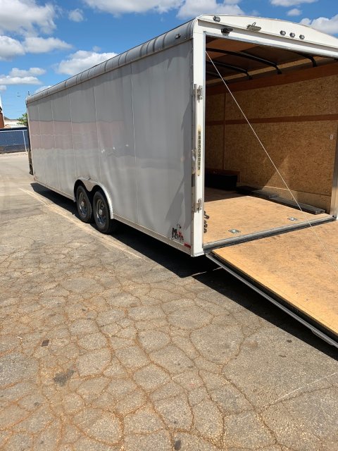

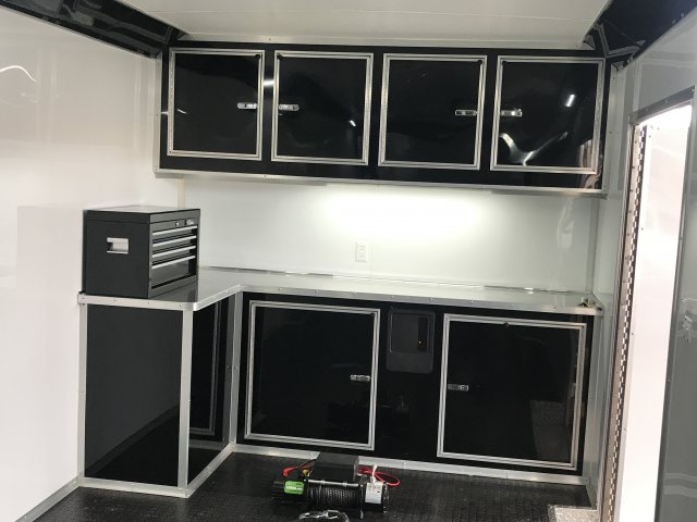

I bought a used 24' Carson dovetail with torsion suspension last week. Been working on it quite a bit. Making a winch mount this week hopefully. Will post pics. I am never good at before pics. To anxious to get started on it.

For my Challenger I use the Petty tie down points mounted to the front and rear k frames.
I'll also be adding a driver's side door before next spring to give me some flexibility. This means at least 4" of ramps to raise the car to allow the door to open just like MarkP is showing.
As has been mentioned I look forward to more ground clearance in the trailer to remove and attach the tie downs. Right now we do this on the ramp for good clearance.

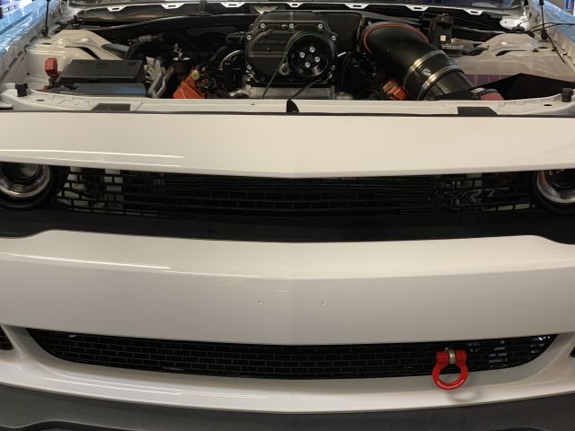

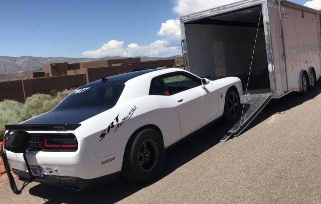

I’ve said this before.... so I’ll say it again. If you run your car at the track..... you could break something. If you do and you are stopped on the track.... you will be pushed or pulled off. With these cars not having a tow attachment point..... expect it to be damaged. They are not going to send out a crew of guys with soft cotton gloves on to push you the length of the track. If you race..... get one if these. 9AD0095D-60FF-48AF-BDCC-F4F709F38CC5.jpeg

I’ve said this before.... so I’ll say it again. If you run your car at the track..... you could break something. If you do and you are stopped on the track.... you will be pushed or pulled off. With these cars not having a tow attachment point..... expect it to be damaged. They are not going to send out a crew of guys with soft cotton gloves on to push you the length of the track. If you race..... get one if these. View attachment 3185
Good advice right there.

Get a tow hook for the front and back. Never know how you'll end up.

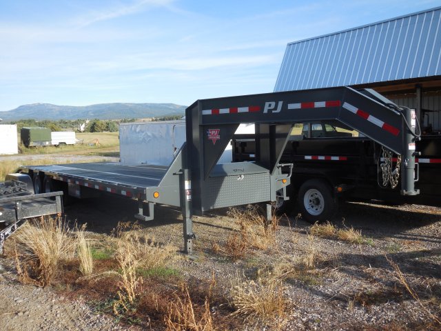

I'm awfully tempted to buy a new 30-foot gooseneck, this time with a hydraulic dove tail.
Wish I'd got it the first time, since the rest of the trailer would be identical, with disc brakes, air suspension, etc.
So, would anyone here be interested in a 25+5 (5-foot dovetail) that's been used three times, one being taking it home from the dealer? DSCN2795[1].JPG
