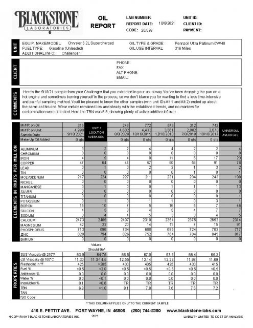

Maybe urban legend like so many other things or maybe some of the 1st people that used it had loose engines? I have been changing my oil once a year or roughly 10k miles for nearly 10 years now on my summer car. I bought enough oil to do 2 changes this year based on I don't about this whole e85 oil thing. I'm thinking on still changing it around 5k and sending it in and see what comes of it. If I'm not seeing anything odd then go back to once next year
I will be changing my oil this weekend so I will collect some so I can send it in. It has almost 9k on it
Also has sat for the winter. So will be curious to see for sure!!

Just for comparison...
(IGNORE the comment about "dropping the pan", I don't do that, they misinterpreted my comments about the oil change process I do.

What's interesting is some people never have issues. Crew Chief Greg runs Renegade K16 exclusively at the track and has for years. He's never had a problem. He did remove his cats a long time ago but his O2s are original I believe on his 2009. Mike's shop Cat ran Q16 exclusively with cats and O2s as a test to see what would happen over time. Last I heard it hadn't had any issues either. Mine would pop the code, I'd clear it, and never have it again until I ran the fuel again. Odd really but I've since moved on to E85 and it's glorious :)
@Smitty the actual analysis is like $40
@BULL so from yours it would appear the break in copper/iron are a thing since yours has so few miles on it and so few on the oil itself. I mainly did this check to make sure my once a year OCI was G2G on E85 and it is no problem. I've had a couple people comment on the video that their older F150 or Ram FFV had comments on shorter OCI when running E85 similar to the towing OCI. I checked a 2016 Caravan, 2019 F150, and 2018 Silverado in my research and none mentioned anything other than Ford calling out to run a tank of gasoline every oil change. Not sure what that would even do over a 5-7K mile OCI though. I'm personally gonna run 1/2 tank of 93 every month just because.

Curious why you worry about the oil after racing events? I've heard of others doing oil changes after a day at the track, and had friends do the same back when I used to take my sport bike to a road course. I never saw any difference in oil analysis report findings either way. Have you seen something?
I went to 1 year oil changes ages ago after doing oil analysis on several cars. Back when I drove more if I hit 10K miles I'd change it then as well if less than a year, but that was a very rare occurrence. On the Hellcat I'd probably pick 5K intervals if I drove more.
When I first went to 1 year on the 4Runner all the internet engineers told me the motor would be coked up with oil deposits in short order. Here it is 20 years later and that never happened.

[QUOTE="Speedy!, post: 243152, member: 1070". I'm personally gonna run 1/2 tank of 93 every month just because.[/QUOTE]
Put a Micro Glass filter in after your pumps and there really is no reason to flush with gasoline that often. If your paranoid of E85 use the Lucas E85 stabilizer with each fill up. I’ve heard from guys that have been running corn for years, they use the Lucas Stabilizer and keep corn in their tanks year round even through winter storage, I use it as well. Me, I’ll probably never go back to gasoline again. I have my oil analyzed by Blackstone every oil change, even with my other vehicles from time to time, no fuel related issues oil wise.
