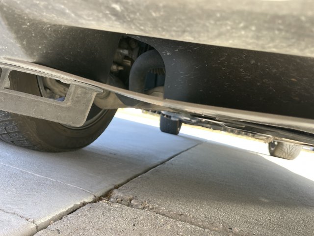

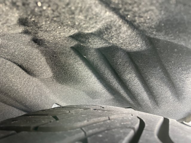

Never knew one side was felt and the other plastic. Here is our passenger felt side. Looks pretty normal.

I'll go double check, but I don't think I have any holes.
However our normal top speed is ~85mph, max speed to date is 105mph.
(And nothing "off road" except a rare road-base driveway.)

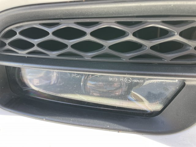

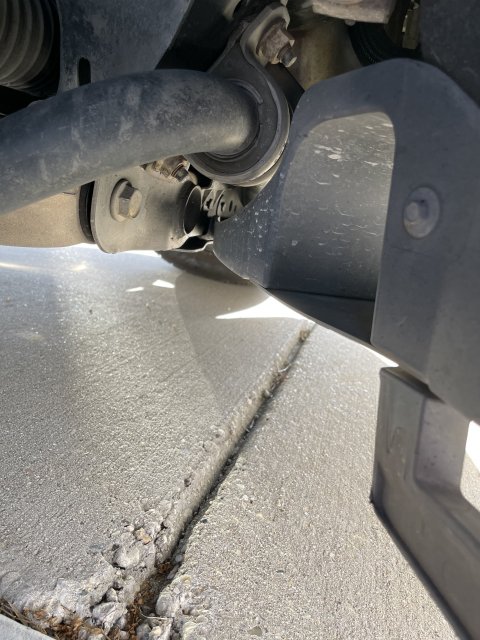

No cooling hole? Does air go into the front or is it blocked?
Comes in through here

So there should be no air pushing the liner into the tire at speeds then. Any hole by the fog light?

Yep and directly behind the mesh is the liner. I don’t think my wife is doing 155 though. Something to keep an eye on. Another possibility could be that the op’s felt not secured with screws allowing more flex. His right bottom screw doesn’t look like it grabbed 🤷

I was thinking there may be a hole there being it probably goes no where would be an option to block it from inside

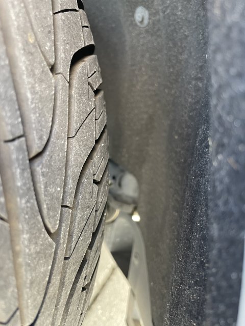

So when I went out and checked, I did not find any holes from either rocks punching through or tire rubbing.
However, what I did find that surprised me is that on the Driver's side, the liner is actually a two piece arrangement, and while the rear piece is the "felt", the forward piece is the normal plastic. On the Passenger's side, it's a single piece, and made of the "felt".
