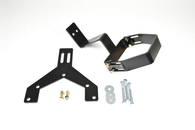

Now came the aggravating part. The website for the track I want to go says you need a ds safety loop for cars running slicks or street slicks. So I put on this g force one for a manual and it does not fit. It rubs the Barton even with adjustment.
The only way I could get it to fit was with 10mm ss spacer I cut that angled it down and away from the Barton and ds. After everything, I wasn’t happy and just took the loop off all together.

I have the BMR part and realized after the purchase that it does NOT fit the 4 inch DSS ds. I saw another owner used spacers to fit on but mine is A8, so a lot less potential for interference. BMW was supposedly making a loop setup for A8 that fits the larger diameter DS......time will tell as it has already been a year and a half.

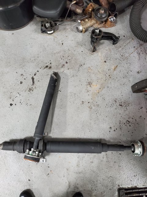

I intend to modify mine to fit no matter what it takes, regardless of the fact that when I did break my ds 2 years ago on launch, it was just before the carrier bearing and in no way could have come out since the exhaust is in the way.

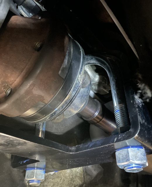

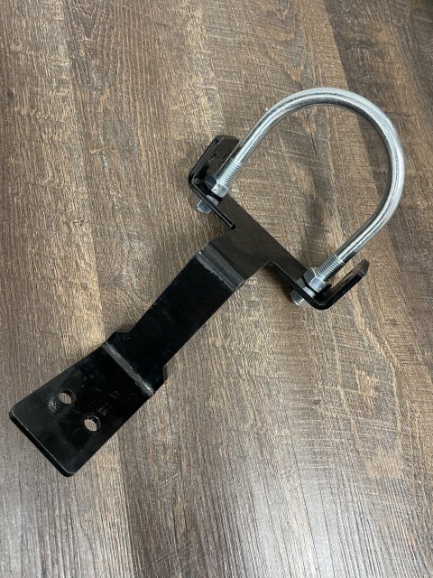

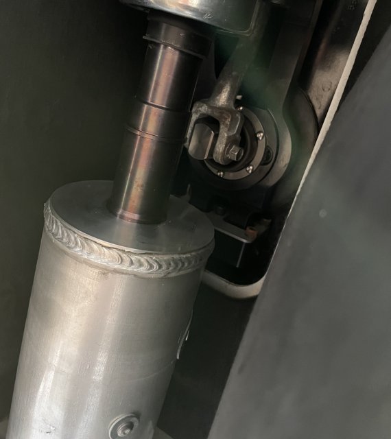

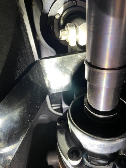

Last time I went to the track they almost wouldn’t let me run because I didn’t have have a ds loop. As much as I hate it, I want to be legal so used a u bolt for 4” pipe, 5/8 thick, and it fits nicely with Barton and dss.
Went from this
to this

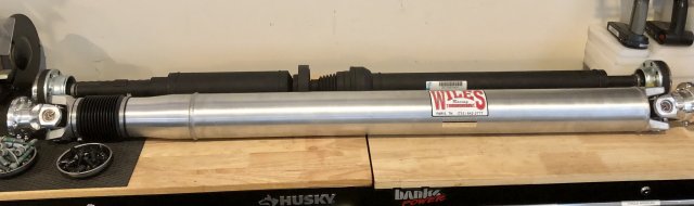

Looks like that will never work for my Wiles, Barton combo.

@ACMAVRO WTG! building the better mouse trap!:cool:
If everything works well at the track, you may want to think about getting involved with a manufacturer to sell your idea to.!
I was hoping it would. I have that same GForce DS hoop, it weighs a ton and why I haven’t put it on. I had that same Wiles DS too.

Remember how tight it was up there just trying to fit the Barton on top of the Wiles? I remember you helped me through the minor clearance issues we had to resolve.

Here is how 4” fits. Not sure the clearance with wiles, looks like It’d be tight but might work. 9267C6D1-3474-4B49-A453-8DDCEE79968E.jpeg
Yep, takes some work but worth it

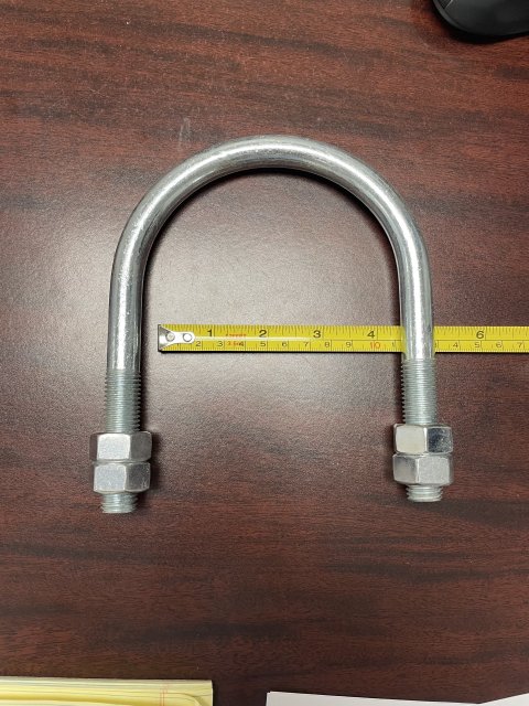

Yes, may work, Where did you get the U bolt from?
My work. It's actually metric (M16).
What size pipe is it for? McMaster probably has a SS one too, I’ll have to look
It’s zinc for 4in id pipe. I looked briefly at McMaster and I think the thickest they went for 4” ID was 1/2”. If you pm me your address I send you one of these to try. The 1/2 may suit you better since I believe your space is smaller but happy to send you one of these if you want
