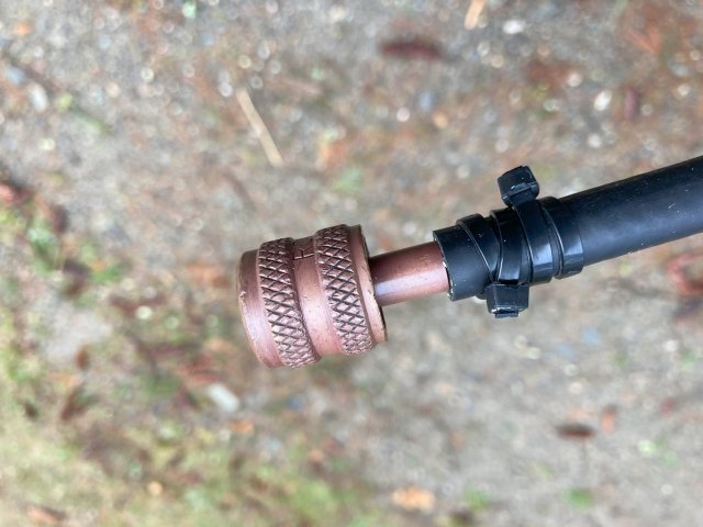

Another member told me that an AC fitting will fit the fuel rail, he was correct. I contacted a friend that did AC service for a long time, now retired. He had a garage full of crap, including a bunch of obsolete Freon 12 hoses, one end of which fits the fuel rail.
I cut off the crimp sleeve and removed the fitting and put it on a fuel line with cable ties. (The same friend gave me fuel line he had laying around.) The line/fitting was maybe 40 years old, the o-ring was trash, simple to replace, but common hardware store (buna) o-rings are not gas rated but it should be ok because it does not stay wet for long, and like I said, it is easy to replace.
He also gave me a relay he had lying around that matched the fuel pump relay, which I gutted and attached 18awg lamp cord.
I had a push button switch lying around that I connected to the other end.
Ran the car until the range said “low” then drained out the remaining 93. About 1.5gal in a minute or two.
Hope this helps some DIY (cheapo!) nuts like me!
Big TY to Tom for the parts!

The guy who provided the parts asked me to clarify that he does not have a garage full of crap, it is all precious vintage collectables, even though he did he best to put as much of it as he could in my trunk!
He asked if using the fuel pump to empty the tank would burn it out. I am not a fuel pump expert but my guess is it should be fine as long as I stop when empty. These things pump thousands of gallons at what, 30-40psi, over 5-10 years. A couple gallons now and then at 0psi shouldn't be a prob, right?
I’ve thought about this as well. The pumps can get hot, and you shouldn’t run them dry. But not sure if it impacts the pumps
Not sure why they would get hotter emptying a gallon or two vs normal operation. And as far as running dry, if they were extremely sensitive wouldn't the pump burn out every time someone ran out of gas? I’m believing the SRT Engineers (the original “real” ones) picked a fp motor that was appropriately durable for the great car they designed. As far as the engineers they have left, I wouldn’t trust them to fix my screen door.
