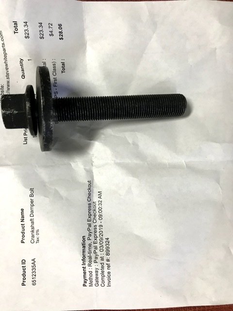

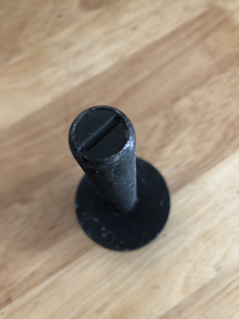

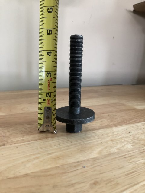

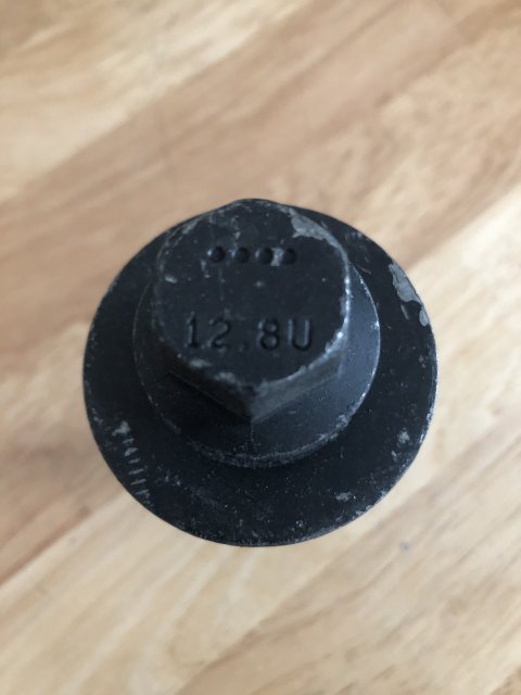

I ordered to newer bolt, part number 06512335AA @Speedy! ’s instruction. After going back and forth with the vendor, who took it upon themselves to change my order and send me the “correct” part for my ‘15 HC, they finally agreed to send the part that is pictured. Only thing is it didn’t come in a parts bag with a part number. In fact what I received looks used. Can you guys look at the bolt and let me know if I’ve got the new part? Thanks as always.

That is the 2018 and up torque to yeld bolt . I'd use that one .

Tony it's like this even if that looks like the correct bolt and as critical as that is I would not use it coming the way it did. I've never recieved a part loose like that and wouldn't use it if it was me. That bolt should have come in a bag and had a part number on it..Jeff

Thanks Jeff, I’ve never received any part with id as well. Since it’s so critical a part I need to know exactly. I’ll need to look @speedys yt video, as I remember he points out the difference between the two. I may just send it back and pick up locally for piece of mind.

I would think if it was used, you'd see a lot more wear on the underside of the washer. But it is a pretty critical bolt so - if you don't trust it, then get another. Not worth the doubt...

I looked at Speedys vid again and it does appear to be the part. Im going to go to my local dealership and pick one up for comparison purposes. Im in no rush for the entire undertaking, but I do have everything I need. My torque wrench is still suspect however and will have to figure that out before hand.

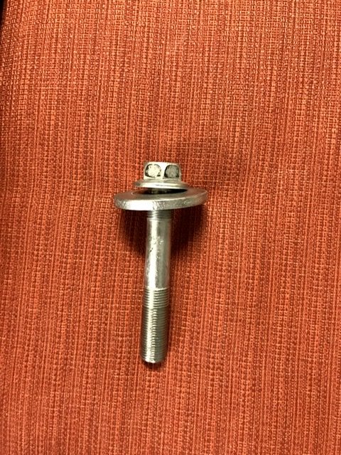

Looks like the one I put in my. 2015 Hellcat. The top bolt is the new one and the old crap bolt is the bottom one. 33294F1C-B922-4D50-86FB-392E356B102A.jpeg 1EC1BBB7-2420-4CF6-BC74-E5302F00F43C.jpeg
