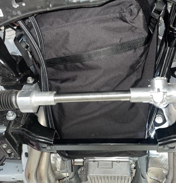

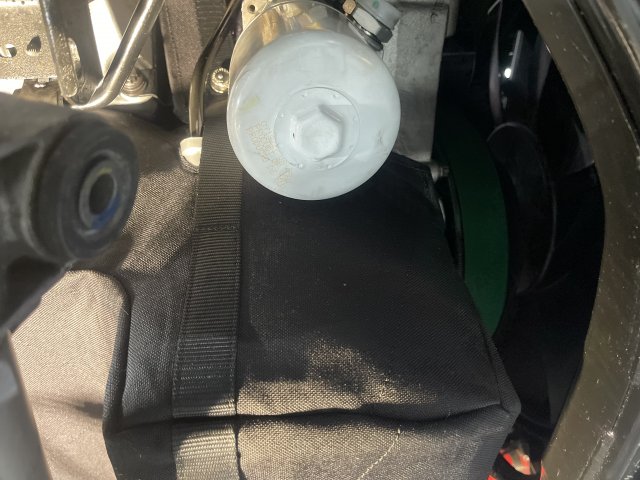

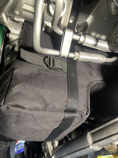

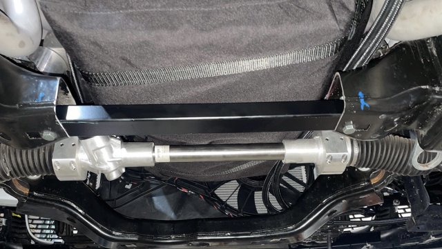

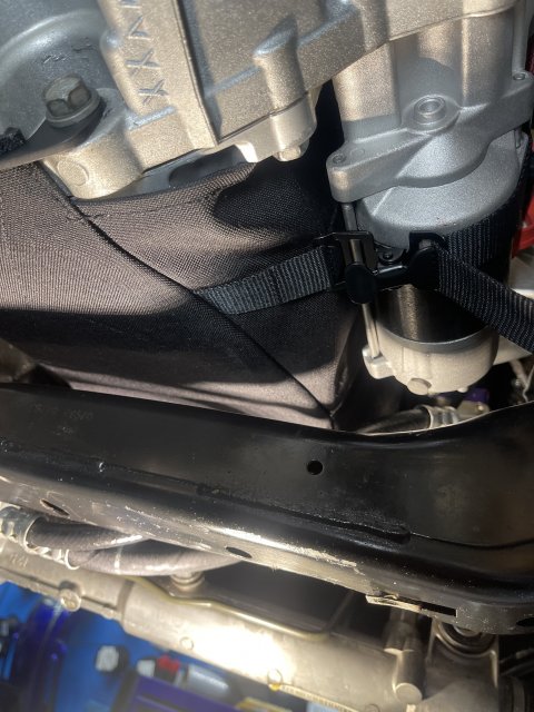

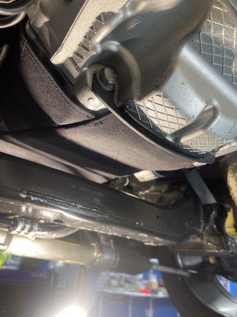

Installing my safety parts. Great fit. Only part that sucks is the rack needs to come down every oil change. But my car is worth more than a little more time changing oil
got from Hemituner performance
Some other brand racers are fabbing an aluminum belly pan with retainer walls and absorbent material in the bottom. I've wondered if that could be created for our cars?
It would be much easier for maintenance, etc.?

That looks like a quality piece. I had the DJ on mine but we just changed to a rear sump oil pan. I know your car is going to be fast so something for you to watch…. Logging data with the Holley, we were seeing the oil pressure drop to 30 lbs thru first gear. Didn’t recover until 3rd. The fact that mine was leaving with the front up a mile probably has something to do with that. I’m sure it didn’t help. The front sump oil pans we have aren’t exactly designed to cars that are accelerating to 60 mph in one second. I keep telling people…. Every time you do something… it makes you do something else 🫤 We had a generic diaper that fit (sorta) on the Moroso DragPak pan. I know that AJ has a specific one for his DragPak so I may check with him on that. 9C538D02-1A85-4621-80E1-55EA5A459890.jpeg DA5EBC26-3ED8-4290-B81A-29AB967D6947.jpeg
