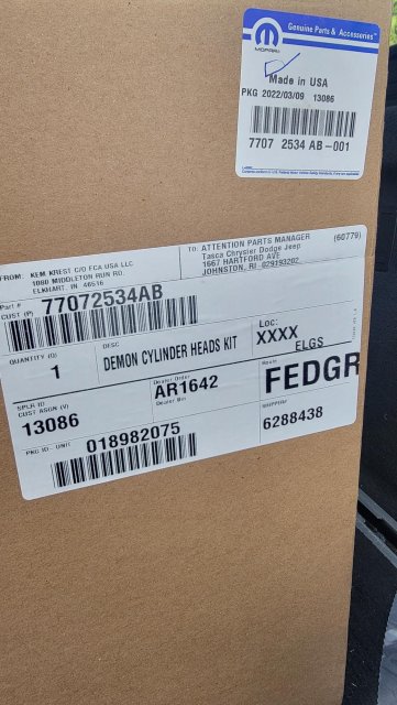

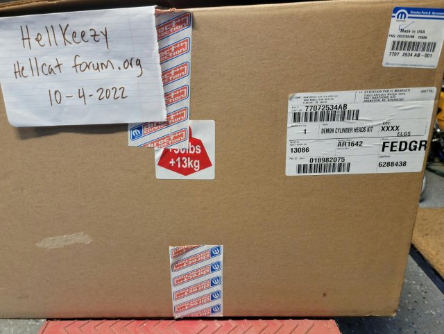

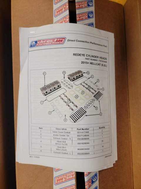

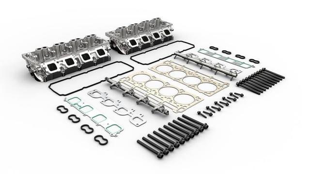

Demon / Redeye Cylinder Heads, Complete Set - Direct Connection (77072534AB)
  • Genuine:
  • Product ID:77072534AB
  • Replaces:77072534AA
  • Description:
    Sold as a complete set, these Hellcat Redeye cylinder heads allow you to increase your 2015+ Hellcat engine redline to 6,500 RPM. Features 2.14-in. hollow stainless steel intake valves and 1.65-in. sodium-filled exhaust valves. Includes gaskets and mounting hardware.
    50-State Street Legal: 2018 Dodge Challenger Demon, 2019+ Dodge Challenger/Charger 6.2L Redeye
    Race (off-road) Use ONLY: 2015+ Dodge Challenger/Charger 6.2L
  • Install Time:8-9 hours
  • Warranty: Parts warranty: 24 months UNLIMITED miles, Vehicle warranty: 3 years or 36,000 miles, Powertrain warranty: 5 years or 60,000 miles
-Brand New
Box opened during Inspection.
Receipt Included for Warranty purposes.

There are no valves shown in the photo? Do you have to do a valve job or seat the valves on new heads? Are the valve springs different than the Hellcat ones?

Cylinder heads come complete with valves already seated and assembled including the springs, also included are the rocker arms, all the gaskets and hardware. I will unbox and upload more pictures tomorrow.

Don’t need to do that on my account @hellkeezy. I’m not in the market. I was just curious if they were ready to run or not. That looks like a really good price for a beautiful pair of heads!
