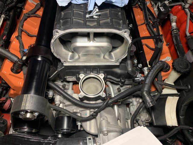

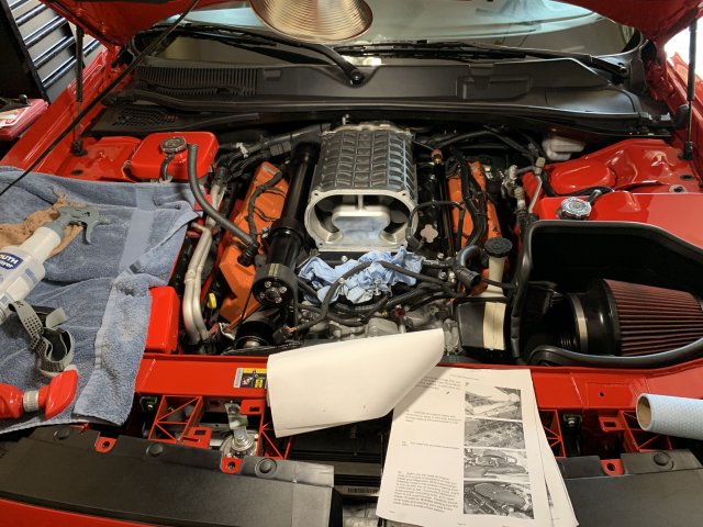

Has anyone used these to rid themselves of P012b/p00fa etc codes when pushing over 18 psi? They are supposed to be 3 Bar as opposed to the 2 Bar found on my 15 challenger. Additional information is this is on a magnuson 2650 vs the oem charger.
Part number 53010887AA
I have 4 on order and hope this solves the random limp mode condition I’ve been experiencing.

I'm sorry to do this to you. I know you have a question you want answered. I don't have an answer for you, but I do have question. I have a '09 6.1 SRT with a 2.3 Magnuson. It has the "trap door /vacuum pod" pressure relief system. I see yours does not. Did they repurpose the stock HC electronic control valve to the pad now covered by the shop towel in your photo. Thanks in advance.
P.S. my system is a 2 bar also. Can't believe they didn't upgrade to 3bar even 6yrs later and on the HC.

You are correct, they reuse the oem bypass valve there. 2 bar is ok for the stock hellcat, but you can easily pass the range of those map sensors with more boost. I hope the sensors work. Tired of popping codes. Eventually I need a retune, but want to wait till I upsize from the ID1000’s to 1300’s before I mess with a tuner.
