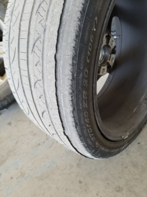

Should we discuss the differences in 106Y vs (106Y)?...what percentage of us are running 106Y?
I actually thought the OEM All Season were OK for what they were expected to do, but after changing to a more performance oriented tire...night and day difference.
sorry, overlooked. Non paratheticals are up to 186 mph. In parantheticals, over that (sometimes by a huge amount). Y itself is for "exotic sports car tires" as opposed to Z, for example, "high-performance vehicles" defined as 149+ MPH. Personally, I've always felt the alphabetical tire speed listings got all F-ed up once you hit the V classification, after that, it's just BS. Check the stats for each specific tire, or surf at your own risk.
It is interesting that testing standards cover Y, but (Y) are up to the manufacturer to develope and track. I never remember seeing (106Y) before the Hellcat, maybe Pirelli developed standard specifically for the Hellcat tires. Some may believe that they would never see over 180mph so why would you need tires for that speed.....I
I would bet that no reputable tire shop would mount any tire with a speed rating less than the door placard.
