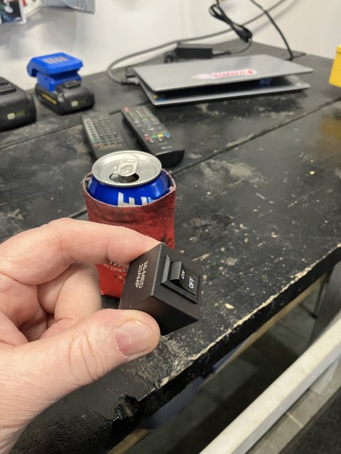

Ghetto
I use one of these when I work on my old cars. No idea if you can even easily get to the starter solenoid on something modern like a Hellcat though.
