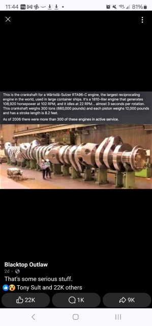

Big Crank shaft

And we thought our crankshafts could handle some horse power lol

Technical data (as of 2008)
ConfigurationTurbocharged two-stroke diesel straight engine, 6 to 14 cylindersBore960 mm (38 in)Stroke2,500 mm (8.2 ft)Displacement1,828.7 litres (111,597 CI) per cylinderEngine speed15–102 RPM[3]Mean effective pressure1.96 MPa @ full load, 1.37 MPa @ maximum efficiency (85% load)Mean piston speed8.5 meters per secondBrake specific fuel consumption171 g/(kW·h)[3][a]PowerUp to 5,720 kW per cylinder, 34,320–80,080 kW (46,020–107,390 bhp) totalTorqueUp to 7,603,850 N⋅m (5,608,310 lbf⋅ft) @ 102 rpmPower density29.6–34.8 kW (39.7–46.7 bhp) per tonne, 2,300 tonnes for the 14-cylinder versionMass of fuel injected per cylinder per cycle~160 g (5.6 oz) @ full load
(Whole engine uses up to 250 tons of fuel per day.)
Crankshaft weight300 t (660,000 lb)[1]Piston weight5.5 t (12,000 lb)Piston height6 m (20 ft)

5.6 oz of fuel per piston per stroke at WOT, must be using ID 1,000,000 injectors lol
Beautiful machinery, especially on a grand scale like this, well.......just makes parts of me tingle and "move" :geek::LOL::cool:
