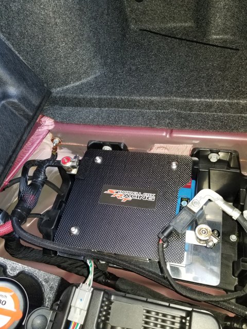

Cool, my battery from them is still going strong after 2.5 years.. 20190406_184452.jpg
