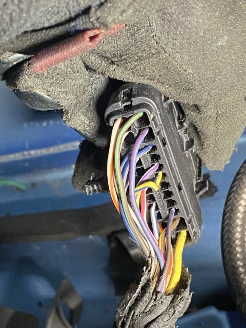

So I accidentally melted a piece to my harness connector and I didn’t take a photo and can’t for the life of me find a pin out for it. Also I can’t just put the same colors that are on my other side of the connector for some reason theu don’t match it the harness to the pcm but not c1 or c2 it’s actually a 24 cavity connector before those and it uses 18 of those pins going to attach pix but if anyone could just take a photo of theirs for me to get the color order thst would be amazing I don’t wanna burn up my unlocked PCM. The one that isn’t destroyed is has only 1 brown wire with yellow tracer however the opposite side has 3 brown with yellow tracer and I can’t get them in the correct order plz help

I know finding this out hard way I’ve got a pic but it doesn’t show the position of the 3 brown with yellow tracer

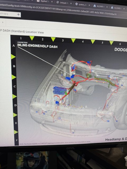

I believe that’s part of the headlamp to dash connector. I just had mine unplugged. It passes through the firewall, and is all part of the headlamp to dash harness that goes to the BCM
8,063
6,982
Yep, I was right. Which side to you de-pin? Side that’s on the headlamp to dash harness or on the engine harness?

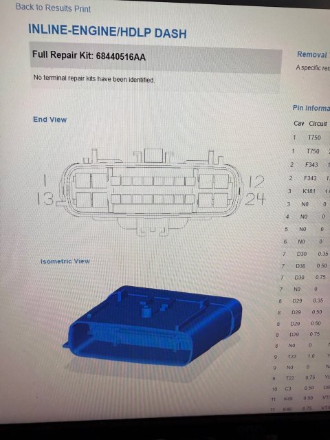

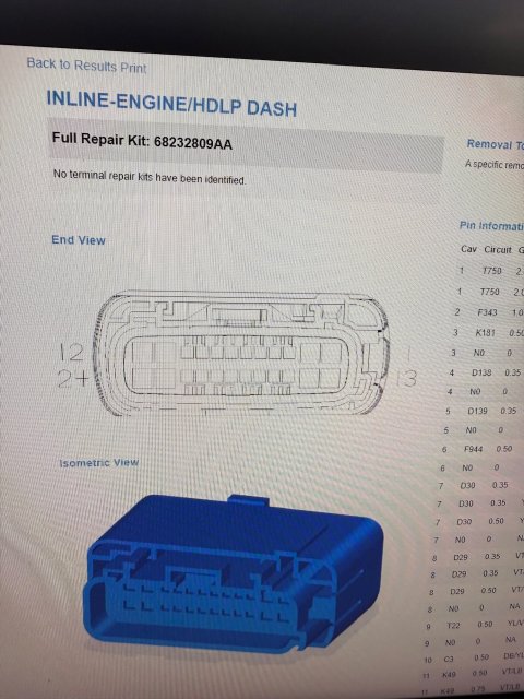

Anyway this is the inline engine/dash and headlamp connector. https://connectorrepairkit.mopar.com/ put year/make and search for “INLINE-ENGINE/HDLP DASH

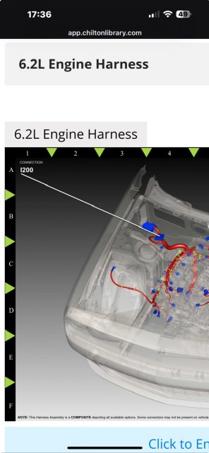

so chilton gives you a wanker name

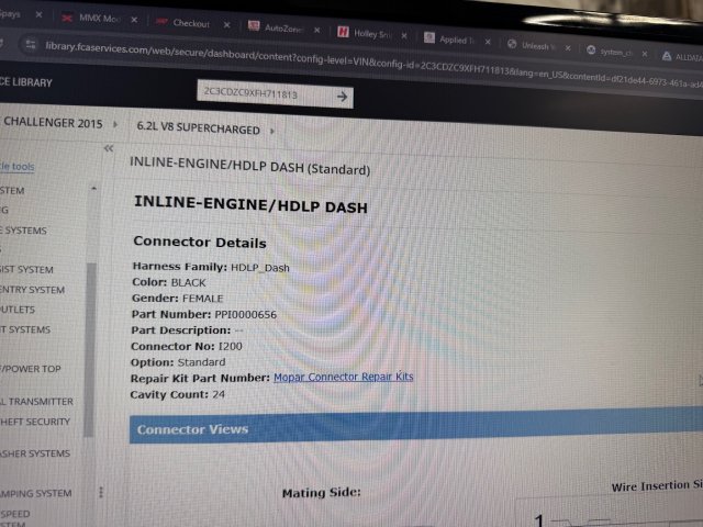

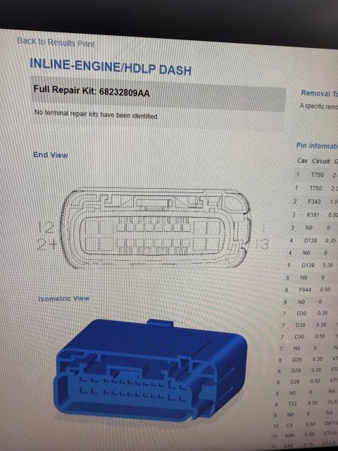

witech gives you the real name
