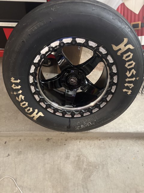

I'm looking at my Hoosier that has been sitting around for three years. It is 29.5 inches tall and without a spacer it was hitting a little on hard throttle response at the strip. So when I do buy new ones maybe I'll stay away from the 30.4 mickeys.

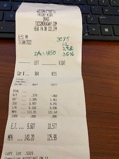

Before my Frankenstein heads and 1700s.with those Hoosiers on at a da of 4100-4500 feet I got a 1.38. Launched at idle in first gear. That was with front runners. I think I'll use the old Hoosiers for October 19th. But no front runners. Then go to the mts in the 50 height.
