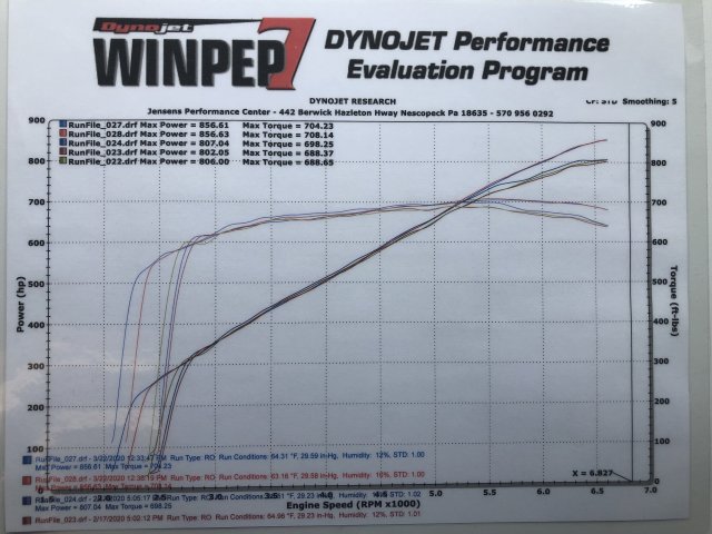

O, BTW making 860 rwhp on 93 at 17.5 psi of boost on a 2,85 Litens with a qt of Octanium for insurance, the data says it all. I test all kinds of products, this one gets 5 stars
View attachment 15143 View attachment 15144 View attachment 15145
That is good info but the can says treats 10 gals. So at 19 gal our Challengers would need two ($44 or almost 2) at a fill up. You use one in a tank and have that success your showing? (1890 millivolt down to 1300 on knock sensors) or you add to 1/2 tank @10 gals.?

Yes, one qt at fill up, usually about 12-14 gallons, so probably 97-98 in the tank with repeated use.

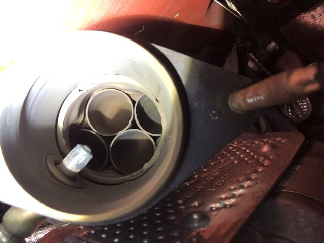

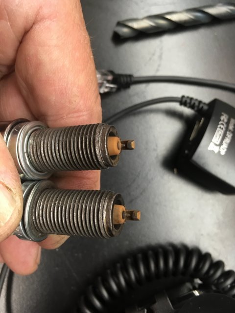

Are you saying the VP didn't leave the orange film on the plugs? You pulled plugs and inspected?
Was there any film at all??

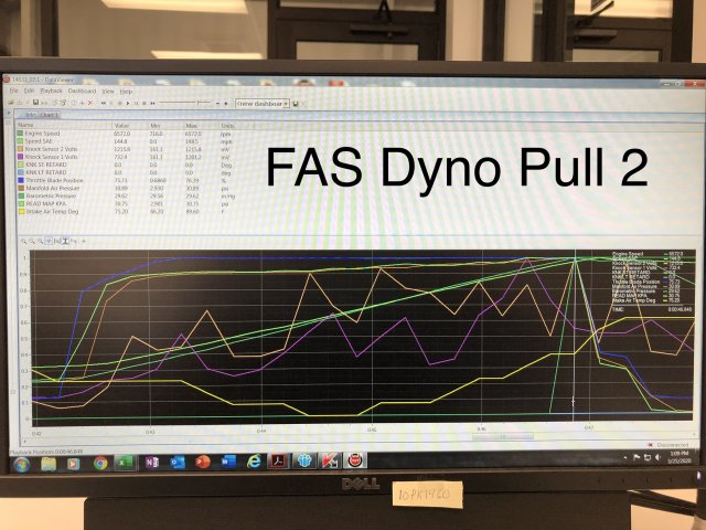

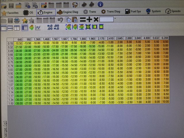

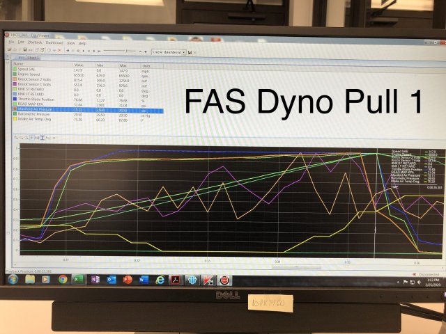

@16GoManGoHC2 you don't show timing advance in your posted logs, how much is it? What was different on the dyno pulls going from 806 to 856?
Winter blend Shell 93 I had to drop my timing down to 10 deg at max aircharge ~1800mg (about 17.5psi). During summer months on summer blend Shell 93 I had it set to 12 deg.
Yes, pulled plugs, very minimal residue, dropped exhaust too, minimal in there too.
0AC41EA8-853F-4655-8A9D-658006812C5F.jpeg 568EEB98-4D81-4DAD-8019-1965362A92E8.jpeg
@Speedy!
Sorry, I couldn’t figure out how to find what you asked for before, is this it??
