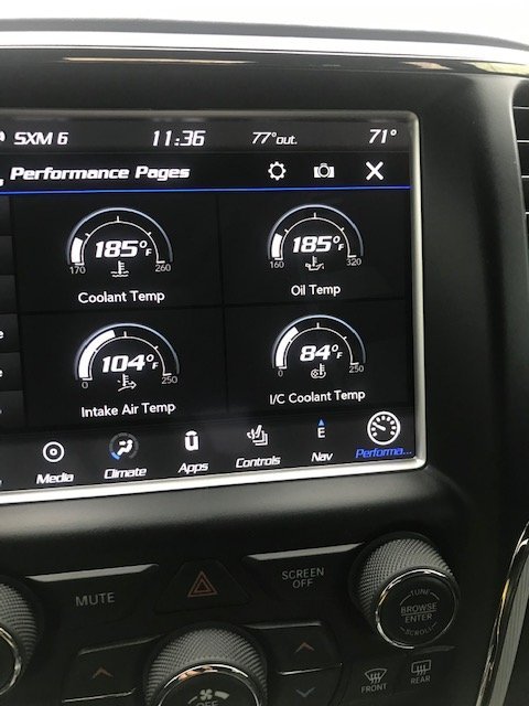

I’m running an AeroForce Gauge on my TrackHawk and the readings on the gauge don’t coincide with the readings of the gauges on the performance pages in particular the Inlet Air Temp (IAT). When I bought it it came with sw 3.8.2 (should’ve let it be) and the IAT’s were spot on with the performance pages IAT so I figured I’d send it in to AeroForce Tech for the updated sw 3.8.3, now with the updated sw my IAT is way off and I’ve switched between platform 1 and 2 and no difference. Would like to know if anyone running an AeroForce gauge is seeing similar readings or your readings coincide with the performance page gauges.

Maybe its reading that temp sensor in the intake just after the filter instead of post blower temp?

Thanks but no, the ambient temp selection on the AeroForce gauges is measuring the sensor post filter in the intake tube pre throttle body, notice it reads 78*-80* and my OAT on the TrackHawk pages today was 77*, the IAT is of course post intercooler temp at the base of the supercharger and the AeroForce gauge should read the same as the TrackHawk pages IAT readout.
These are this afternoon 30 min drive into work:
887423F0-AE33-4DD1-BE17-474BF375595A.jpeg 95908D25-664E-432C-9117-71ECF4DB8100.jpeg
