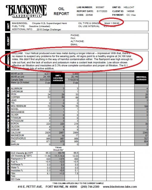

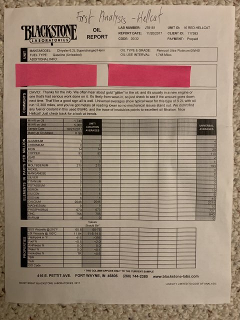

Thread Starter #16
One thing I notice now comparing the Mobil report above with my Pennzoil is the molybdenum contents. The Pennzoil had a whopping 215 while the Mobil only has 72-75 while the universal average is 193. Another difference is the Boron level of the Pennzoil is only 5 while the Mobil is around 220. Universal average is 19. That’s also a huge difference in the other direction. Maybe they both do a similar job and Mobil chooses to do it with Boron while Pennzoil does it with Moly? D54E91ED-FE5B-4CBA-BD69-CF92420ACFE7.jpeg
