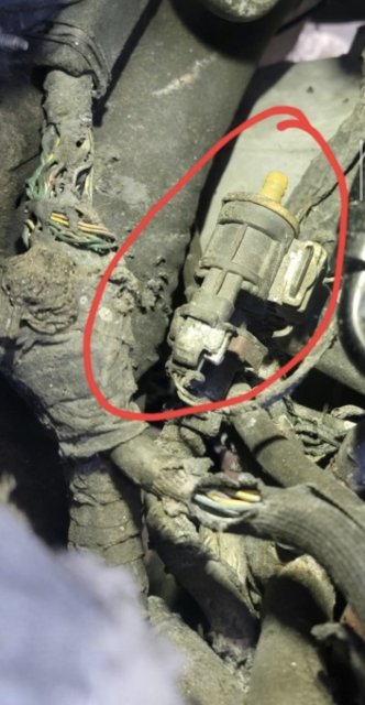

As mentioned in the other place, I’d start here. Wiring is in really bad shape. I’d replace both headlamp to dash and engine harnesses with NOS, can probably be found on eBay. Also, a short to ground won’t always appear as a CEL on the dash. You need to scan the BCM and possibly PCM. The car will demand the voltage it needs.

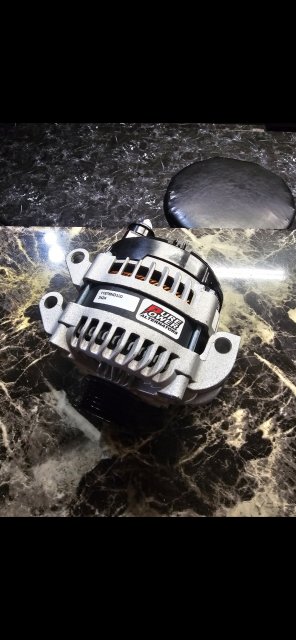

Anywho, alternator was the culprit. Another member on other site having same problem, same fix. Alternator.

New alt
