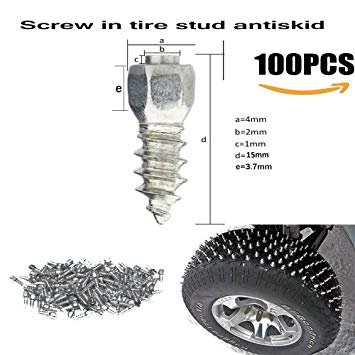

Next time your looking for tires look at the Goodyear wrangler duratraks they come pre drilled for studs. Just buy the studs and screw them in. As for chains I have never used them I got duratraks. You can get custom big studs that are like mini spikes

I used to snowmobile every weekend in the mountains...studded winters are the way to go for sure. (edit: NOT the studs shown above, LOL....normal DOT approved studs)

Yup studs are the way to go. The reason I showed him the big spike studs is I think he is using them for off road hill climbing
