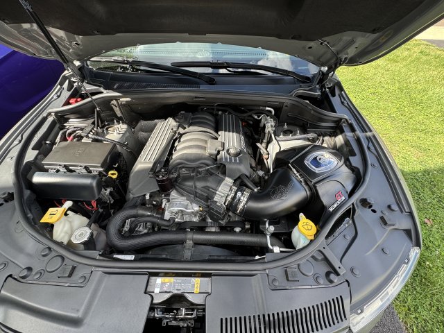

Today I picked up a AFE Momentum GT Sealed CAI for the Durango.
It was easy to install, and removing the factory box took all about 35 seconds. Install I took my time, wiped down the area where the intake was going in and it still only took me about 20 minutes or so.

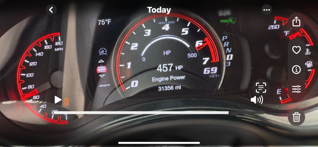

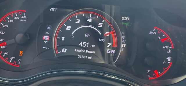

3 - More HP. I didn't Dyno it or anything just did a few pulls before I put the AFE in and then a few after and got an average which basically stayed the same each time so there's that.
I gained 6 HP, not 31 HP like AFE Claims which I knew it wasn't even going to come close to that but I'll take 6 HP over stock.
How I figured that out was comparing points on the RPM range. At 6200 RPM to be exact. I took pictures of videos I filmed at the highest HP numbers and compared. I'll post them here.

Always wondered what gives when there's no (at least not obvious to me) give between the engine and a fixed air box.
Is the filter box floating to some extent?
M
#27285
47
78
Croydon
2021 SRT 392 Durango
Well yea and No. The new Air box attached the same way the factory Air box does. It uses the factory Rubber grommets and factory pin location for the air box to be a "Press Fit".
On the Chargers, they also have a single bolt that holds the air box in place, not on the Durango.
