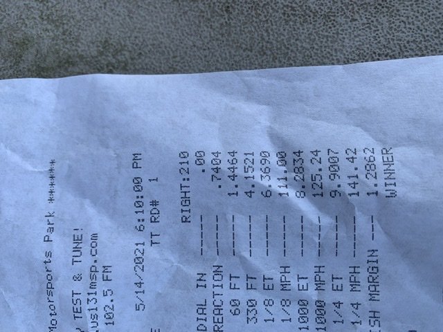

Well I had two goals today. Work on my 60ft and run a 9 and my first pass I did just that.
I don’t see a whole lot of people with a 2.85 and E85 especially flex fuel.
My mods are
Flex fuel tune
2.85 - grip tech
Fic1200
Tapp performance dual pump
180 deg thermostat
305 45 r17 et street - no front skinnies
Aad drag pack
This is still with the 2.62 rear
Full weight
Da1400
aad drag pack had to really help look at that 60ft
Unfortunately, this was my only good pass of the 3. The car rubbed on the suspension wire again. I think the guy when he alighted it cut my zip tie and it hit on my second pass.
Needless to say I think I can do better
My go pro didn’t record. So here’s a cell phone video.

Hooked good and a pretty good mph. I’ll bet it has better ET’s in it’s future!
56,169
190,646
I stayed at the track after my race to watch. Pretty cool to go 9.9 when your tuner says it probably won't. Just wait until he gets negative DA 9.7 maybe 9.6:)

Awesome job! Congrats.
The mph is surely there. So is the 60ft. I’ll just put some rocks in my shoes and I’ll be good to go 😂

negative DA, skinnies maybe some other tweeks and 9.7 for sure! I think 9.6 are a possibility:)

This is awesome! That 60’ is moving! Congrats!

That's a great run and really good mph and 60' for a 2.85 setup. Humidity definitely matters, water doesn't compress 😉
Welcome to the 9 second club.
