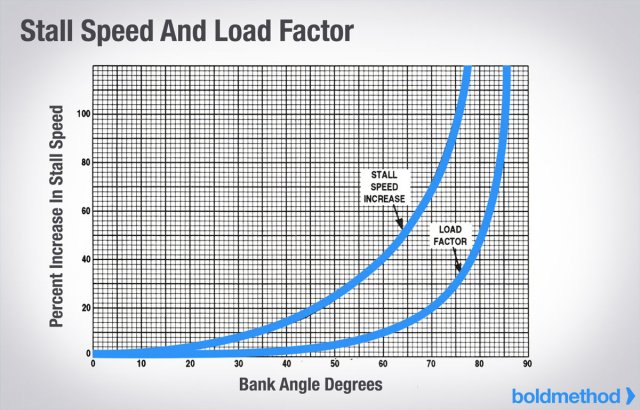

Ghetto
The captain on that flight, Bud Holland was known to be a real cowboy risk taker behind the controls. There were many other times he nearly crashed a B-52 including clearing at mountain top by only 3 feet at very high speed. There were guys that smartly refused to fly with him. If I recall correctly he was only 2 knots below stall speed at that bank angle, but it was more than enough to seal their fate.
A visual on how bank angle increases stall speed.
