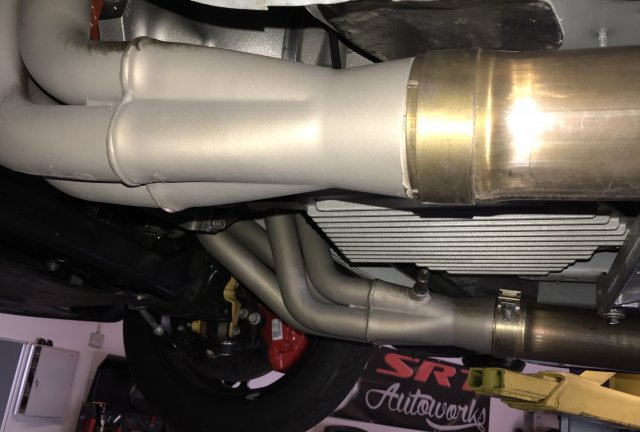

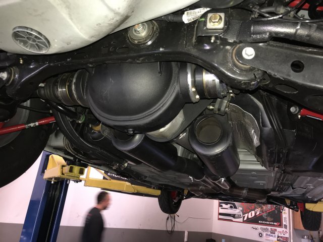

Not sure what you’re looking for. ARH has a 2x3.5 header. I have those. The X-pipe on that is 3.5 but the mufflers step down to 3.0. I had to build a custom muffler setup to keep the 3.5 all the way back.

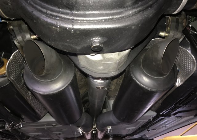

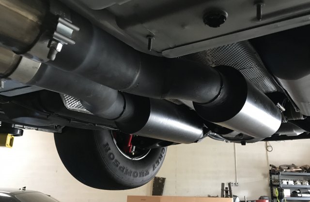

Yes. They just came out with the 3.5” collector in the last year. I purchased the headers and 3.5 X-pipe and not the 3.0” mufflers that come in the complete system. Then I custom fit the 3.5” straight thru Flowmaster Race mufflers. Alex at BBP said that my motor would benefit from the bigger system. B31C17E0-5DDC-498E-8B40-61AD067541A9.jpeg

Wow. That was a barrage of info. I just took some pics of mine yesterday. ARH 2x3.5 with 3.5 Flowmaster Race muffs 5CEB5794-97EF-4D7A-A3CF-11F284B9E877.jpeg 04E7CB3E-A5E1-4293-845C-80D652235424.jpeg 06932C46-91E3-4631-90C9-59DF52953BA0.jpeg

That’s great! I was just surprised that somebody took the time and effort to do that. 🤗. A lot of good info for shoppers there.
