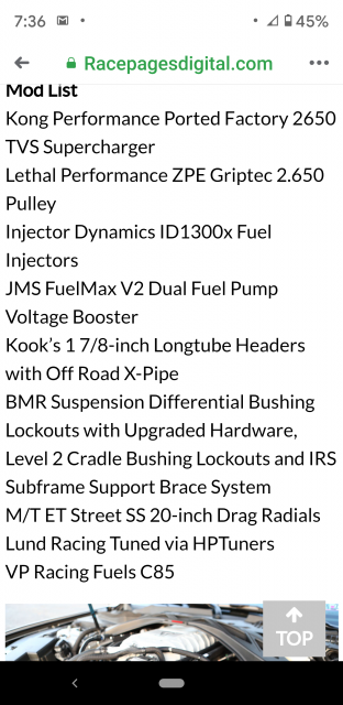

If you watch the next video, the guy is saying 940rwhp, ID1300 injectors, JMS Fuelmax V2 Dual fuel pump voltage booster, kooks long tube headers with off road pipes, BMR Suspension diff bushing lockouts, level 2 cradle and IRS support brace, VP C85. Along with the mods listed above.
1.63 60ft. Sounds like they need to get that 60ft down more.

Here is the mod list as published by the NMCA: Screenshot_20200103-193628.png

Yup that's what I've been reading too. I mean is there more in it? Sure probably. How much can the DCT take though after they take off torque management? They have 940rwhp and can only manage a 1.63 60ft? My Redeye can run 1.4x 60fts stock on tire. If the argument is they were on 20's then why spend on the money on other mods when wheels/tires should have been the first then? Granted the DCT is meant for more than just 1/4 mile. However, since it's 1/4 mile we are discussing here I see serious drag racers ditching the DCT in favor of another transmission. Especially if they start going threw them after torque management is turned off. DCT has it's place, but after all those mods I'm loving my A8. A Hellcat can go quicker than that with similar mods, not to mention a Redeye can do that and quicker on tune ONLY (E85). Granted they just started tuning, but to be excited about a 9.9 with 940rwhp seems underwhelming to me. I don't doubt I could easily cut better than a 1.63 60ft on 20" drag radials, stock Redeye. We shall see how things go after the TCM is tuneable and torque management is taken off. So far as a drag racer though out of of the box the DCT isn't impressing me.

Sorry guys, I'm really not impressed. My Redeye with just 2.85 upper, tune (plain 93 tune, no E85 or 109 tune), demon springs, cat delete, and Mickey 17" R, full weight......in good weather ran a 9.92 @ 137, compared to all the mods this car has and the lighter weight of his car that ran a 9.93 @ 140 with a claimed 940 rwhp. My dyno was 716 rwhp on a stingy Mustang dyno.....so things like dyno, track conditions, and weather are variables and I understand that.
For all the mods listed and dyno number, I was expecting mid 9's at the worst. Perhaps with a driver mod or more break in miles on the car the times will drop, I really hope so. That's a lot of mods for a car that supposedly runs around 10.9's or better in the quarter, bone stock. I totally agree with MaxCarnage that they may need better tuning and a better 60', and I also agree with blkout that the car needs 15" or 17" rims with some Mickey ET R's or some other tire.
I'm sure given more seat time and tuning time, plus different rims and tires this car should improve it's time greatly.......but again, with the mods listed and the starting horsepower of the bone stock car to begin with, I'm not impressed.
Lastly, I'm not bragging on my car, but using it to compare. I do like Fords, perhaps my disappointment is similar to the Demon owners who expected a 9.65 and didn't get it. Given the mods listed and the hype, I was just expecting more.
