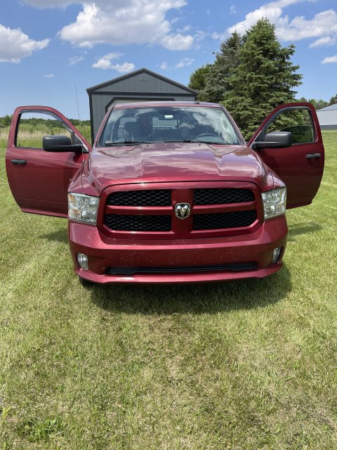

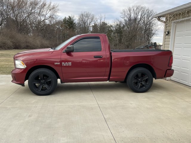

Current state with new hood and grill installed, the other pics are parts piling up and one with winter tires (original chrome rims) and one with summer tires (black factory sport rims)
