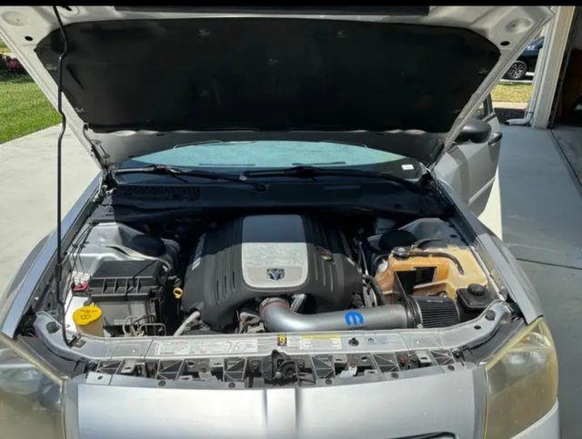

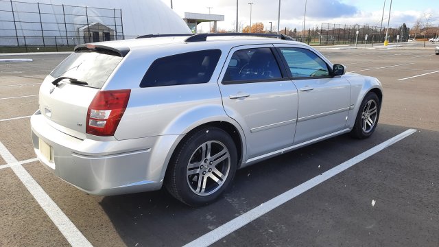

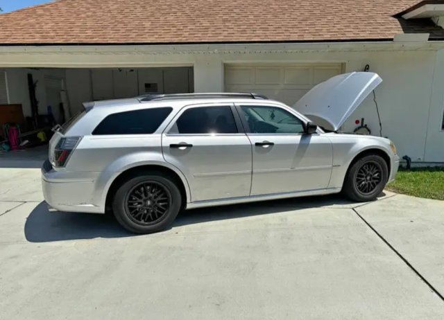

Headlights look badly yellowed, cover over the rad support is missing, mirrors and door handles should be body colored. It has a prop rod, mine had struts, they did switch to to rod later but struts can be retrofitted. It is manual single zone hvac. The tail lights are aftermarket. Since it has a roof rack, it should have a cargo organizer in the hatch. It's just a lidded box with netted compartments to help keep bags upright.
It looks like someone did some "customization" on it. I'll know better when I see it.
