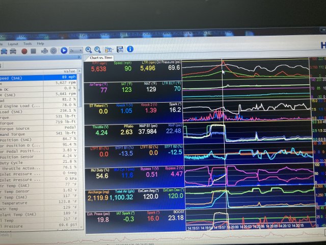

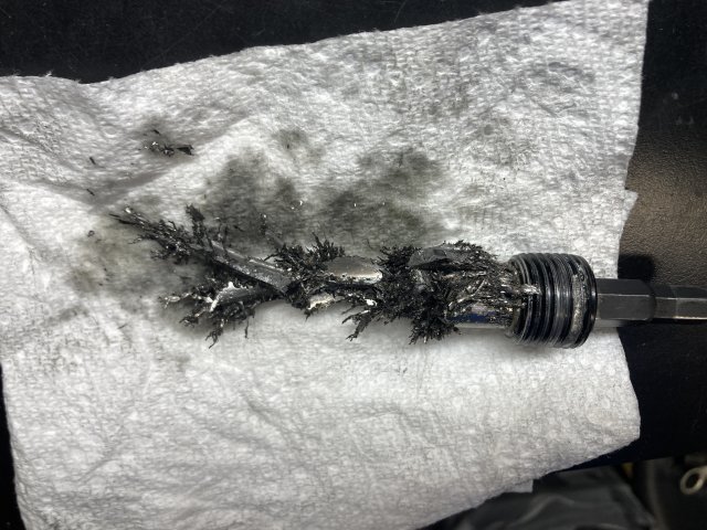

This is second Tranzilla I’ve had in the car. First one was a 2.98 ratio 4130 gear material trans, it broke on a 2-3 shift not far from where it broke this time on a third gear pull. This transmission was a 9310 material transit that RSG told me would be unbreakable at my horsepower level. It lasted four years and 4000 miles. I’ve contacted them, but I don’t think they’re going to do much as far as discounting a repair or definitely not repairing it under any type of warranty condition for sure. I have been contemplating selling the car for probably a year now because life turns have just taken away the time I had to enjoy it and I’m needed elsewhere with family of late. So at this junction in the road has now forced me into a decision of what to do. I will be removing the transmission and taking it to RSG as they’re only about two hours from me and seeing what they have to say about it once they pull it apart. I will be mentioning to the man in charge there because I’ve known him for many years now that I have been very influential on getting him business and will post how I was treated with this transmission that I was told I could not break. Anyways, here’s a screenshot of the log where the transmission went loose. It could be seen at the top where it gained RPM quick that’s right where the transmission let loose. I just did 260 to 130 pools prior to that happening and ran a Camaro and kicked his ass across the bridge and was testing to see how asphalt traction was because I had just made some suspension adjustments that morning and I wanted to test how they were. It definitely gained attraction from my Rear wheel alignment adjustment, but unfortunately ruined my day on my way home to put the car away. Been consistently running 5.75 to 6.0 60 to 130 times and it’s current set up. It pains me to think about putting this chapter of my life behind me, but I’m at the crossroad at the moment. I have many many many spare parts around for this car two superchargers want a brand new demon one brand new set of demon heads in a box a full set of interior leathers all the parts that were taken off of it , 2 HMI’s , 1 a 2017 unit with CarPlay, spare original PCM, two NIB differentials actually Three one used two brand new 373 and a 390 and probably a lot of stuff I’m forgetting about if someone flush with cash wanted to step into my place 65K would take it all, that’s one hell of a deal, someone could probably gain back 20 K in parts alone if they sold off just the parts in boxes.

The Soon to be finished rebuilding 9310 2.66 First Tranzilla will be up for sale. I sent my GForce outlaw axles back for check out as the wheel hop event when I was at the track last year left me with a noisy CV. Well, it turns out that the axles are junk. Both of them have twisted center diff side splines, twisted axle bars, and twisted outer wheel side splines. GForce made me a deal on replacement set for $1900 for a brand new set. If anyone wants them, let me know. I will hook them up for that price, axles will ship direct from GForce to the buyer. So if the Axles took that much damage that probably started a crack in one of the trans gears and it finally let loose. That made me feel a little bit more comfortable on the strength of the transmission as it did last over 4 years and 4000 miles and many many many quarter and 60 to 130+ hits, Just wheel hopping is not good for anything.

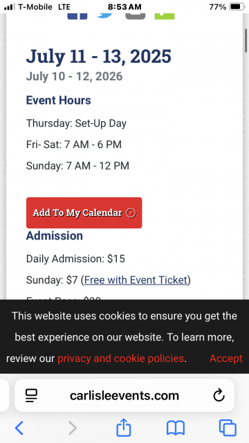

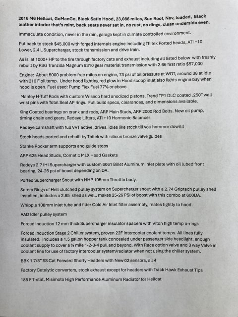

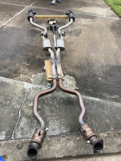

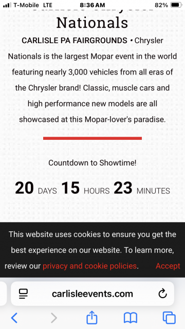

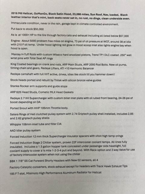

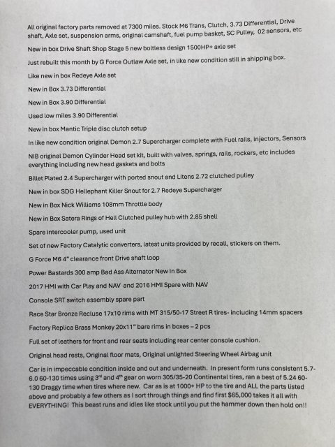

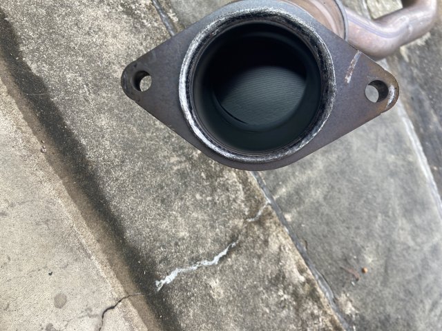

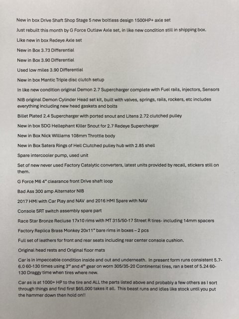

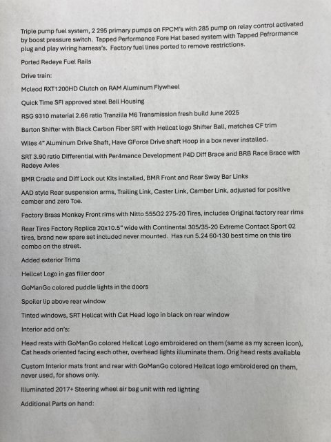

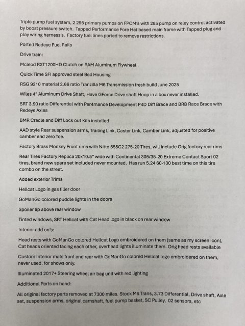

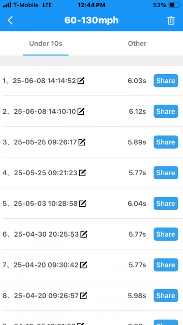

Edit to post 1, new pictures of included items, added item missed on previous lists. See below latest list and prices. 2.66 Trazillla at RSG rebuild shop for full rebuild. Car is most likely going to the big Chrysler Mopar show in Carlisle Pa weekend of July 11th in its 1000+ to the tire form with Trazilla back in it for now.

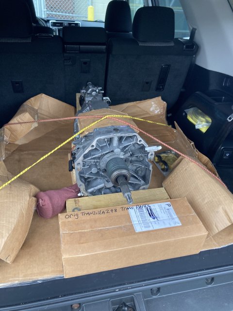

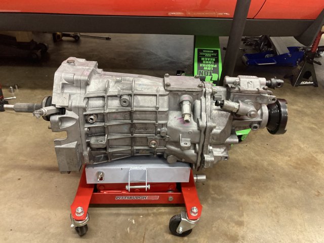

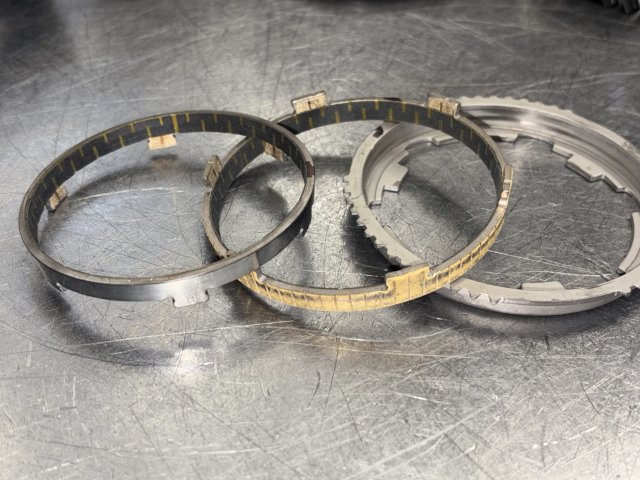

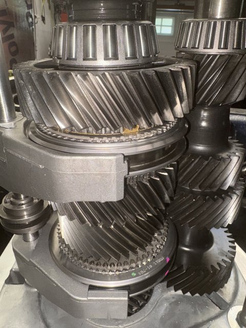

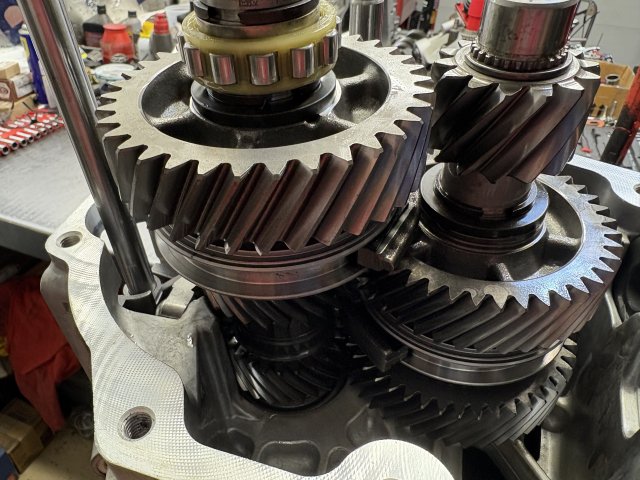

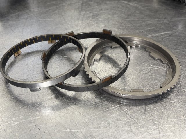

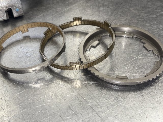

New Tranzilla build done and ready for pick up. All new 9310 gearing, even a new case as broke original internally :( Only reused part will be the front plate. Using a custom hybrid brass CF synchro set for the 2-3 shift this time to improve shifts as the only synchro it was a factory mod in the Z06 TR6060 to improve high rpm shift quality on the 2-3 shift. I may have to try it for myself IMG_1731.jpeg IMG_1726.jpeg IMG_1723.jpeg IMG_1724.jpeg IMG_1722.jpeg

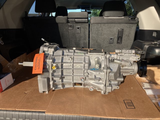

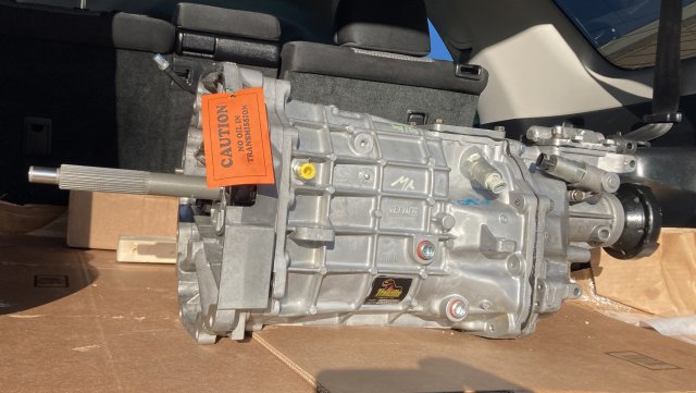

New Tranzilla in house. When I say new it pretty much is as it’s all new parts except for the front plate, the tail shaft housing,output shaft, and the shifter input assembly. The rest is new, including the main case and everything inside it.

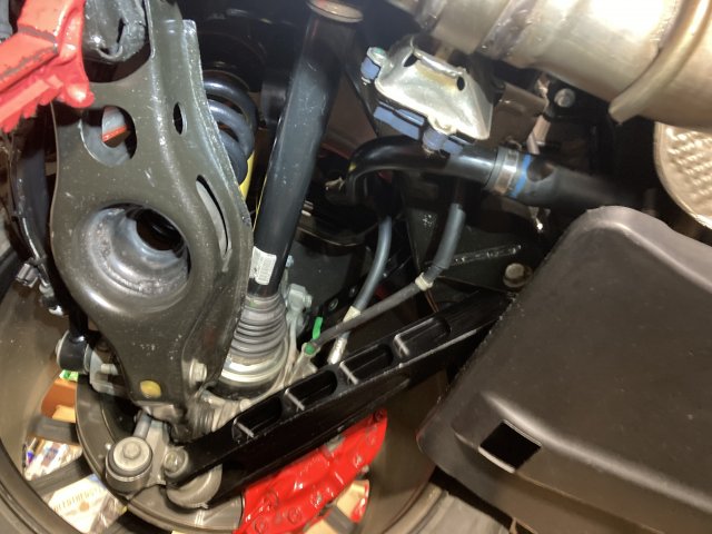

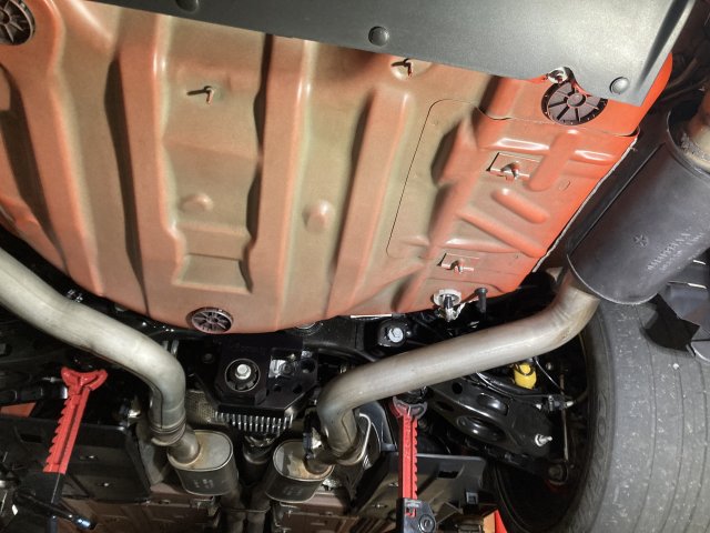

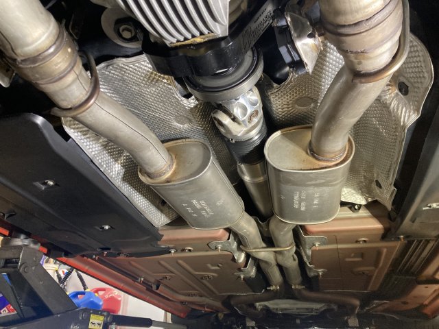

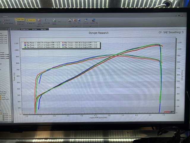

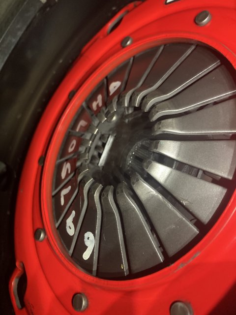

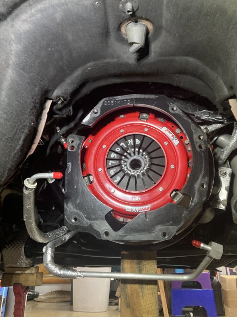

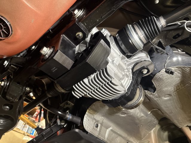

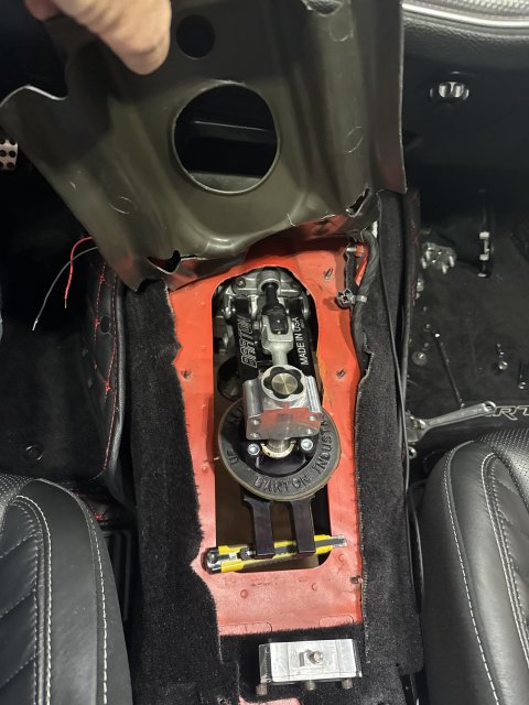

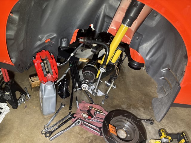

So I couldn’t bro g myself to putting it back to stock, who wants 625 to the tire when 1000+ is tried and true for 6000+ miles now. All put back together with new McLeod RXT1200HD discs, new RSG 9310 material 2.66 close ratio transmission, had Wiles go over the 4” alum Drive shaft, new SRT 3.90 Diff, and a new set of Redeye Axels. Finished on Thanksgiving day and took it for a short 10 mile test ride, super smooth and quiet now :). IMG_5358.jpeg IMG_5366.jpeg IMG_5387.jpeg IMG_5386.jpeg IMG_5385.jpeg

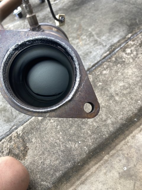

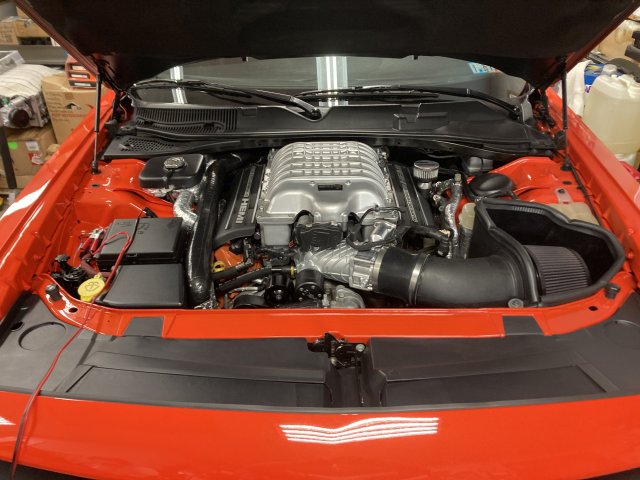

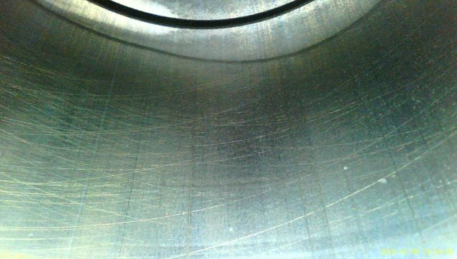

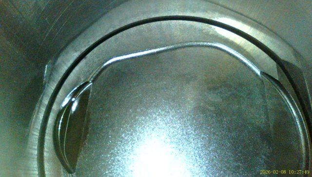

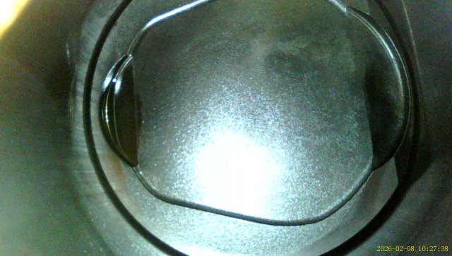

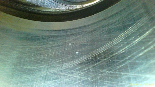

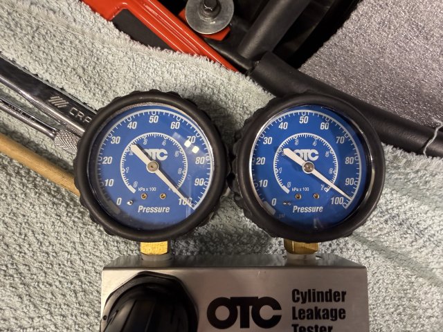

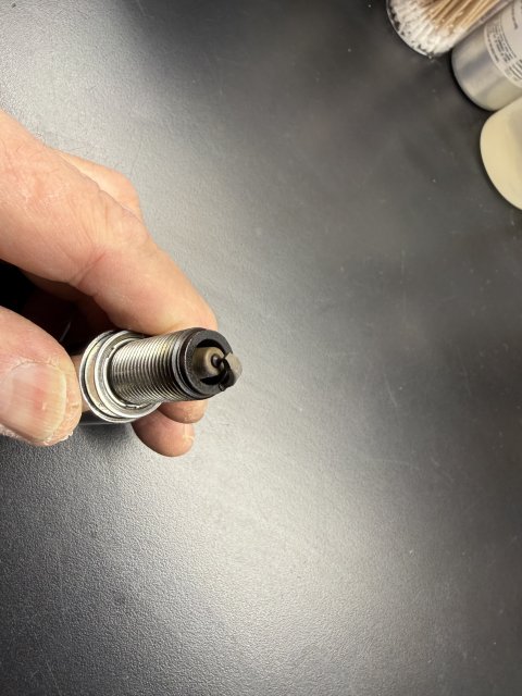

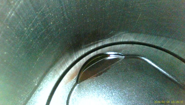

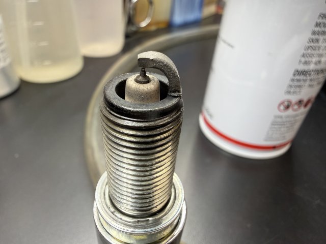

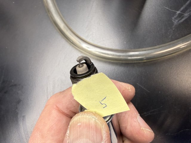

Over the weekend I did a spark plug and cylinder examination and leak down check of all cylinders. Happy to find after 6000+ miles at 1000+ to the tire engine is still perfect yet. 2-3% leak down cold, plugs burning great, She passes the tests for yet another summer of fun for me or a new owner. She’s almost as clean and new looking as the day I bought her except MANY upgrades inside and out. Tastefully done. Open to offers still. Corn burns CLEAN doesn’t it!!
