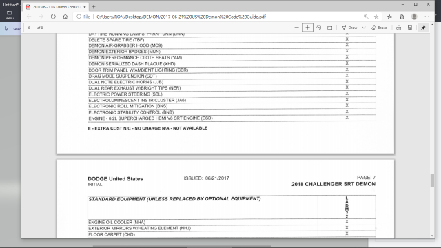

I checked my "As Built" from my 1320 and it has the same code as @DRAGRCR posted above "SDT Drag Mode Suspension". It doesn't give any more detail beyond that, which is weird because it does list the code for the rear stabilizer bar.

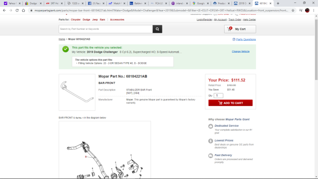

found this
List of parts. From a Dealer. Must have a Demon Vin to order.
(2) 4782718AA
(2) 4782722AA
(4) 6101848
(4) 6500399
(1) 68184221AB
(1) 68184226AA
(2) 68217934AA
(2) 68257343AA
(2) 68312673AA
the last numbers on the list 673AA are the bushings so it appears Demon and 1320 use same sway bar

it appears the bar is from a 300 3.6. like I said, they probably found the lightest bar they already made and used it. The bar is available every where.

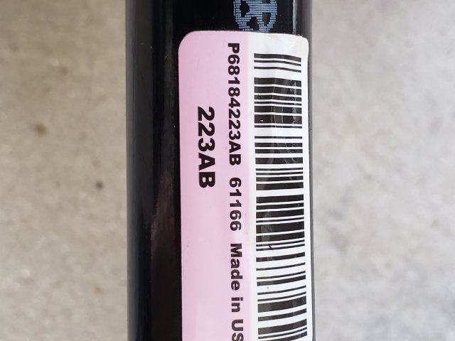

Well our heavy ass Chargers are not getting the weight from the sway bar. Hellcat Charger sway bar weighs 10 lbs. This is bar only no end links. Good news is I don't have to buy a light weight sway bar, I have one 68184223ab. Can't believe the Challengers are getting an 18 lb sway bar. Maybe mine is hollow and those are solid? hellcat charger bar.jpg .

2016 Challenger Hellcat front bar 68235661AC weighs 20 lbs bar only. Sure the 2018 bar is same part number
So if you have a Challenger Hellcat you can save some weight
