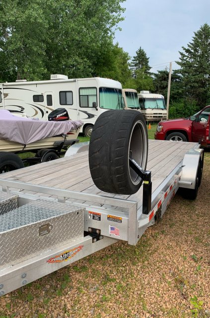

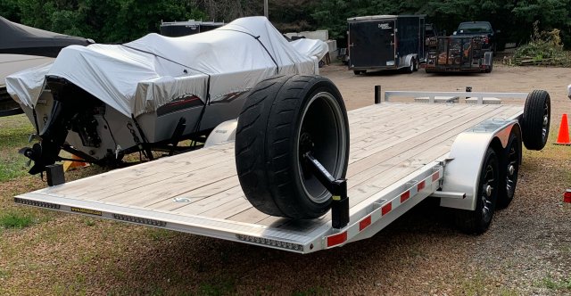

This year I have been on the road twice. We believe the Grand Cherokee blew its air suspension out on the way to Oklahoma because we flat loaded everything nearly including the “kitchen sink” including two big guys into the Jeep, then expected it to tow at least 6000 lb. That payload in the Jeep included four spare wheels/tires. Okay, going over to Wisconsin I distributed the load back to the car and basically strapped the four wheels/tires on the trailer. Well, that worked, but the strapping operation was not nearly as straightforward as four motorcycles! It wore me out and simply took too long to accomplish. We could make a cage in the front of the trailer. We might next year, but for now, I needed a budget fix fast. I need to load it tomorrow night again.
So sorry, if you don’t read above, here is your solution.p:
Rigid Hitch; Burnsville, MN - the mount made for little spare tires using the stake holes on the trailer.
You need to be able to mount big wide tires. So I ordered a set of 1 1/2” wheel spacers!
That seemed okay, until you consider hanging them to the outside results in a Wide Load. No, no, don’t need to do that. Here is where you are on your own, but the solution is easy for anyone who can work steel. I put the car on the trailer. Trial fit where the tires will fit. I measured the difference in height necessary, because turning them will require raising the mount. The front is more tricky. You need to use the absolute last hole to clear the front bumper, but it holds the wheel up over the trailer rail.
Phoned a friend who is in the business of steel fab, & welding among other things I need for business. It was easy work for them using 1/8” thick steel and good welding, which they are known for usually doing pipework. We simply made some “adapters”!
Tomorrow night will be a breeze getting ready for the short trip to Baxter, MN for Mondays’ lapping exercises! I’ll post up some of the loaded pictures then.

My 2018 Jeep GC TrailHawk has a towing capacity of 7,500 lbs. Having the correct tire pressures for the load is important.
View attachment 19006 View attachment 19007
I did something similar on my car trailer, but I had the tire mounts attached to the front fence rail across the front. I had plenty of room in front of the car because I would center the car over the axles, if not a little more toward the rear for cg purposes. Your idea is better I think because you can move them around.
I could except for the Challenger is suck a big boat! Using a 20’ and there is room behind for the two, but that front has to ride all the way forward to clear my front bumper. Got one wheel/tire not attached, but that part is easy now. Hell the car can carry it and the jack in its trunk area.
