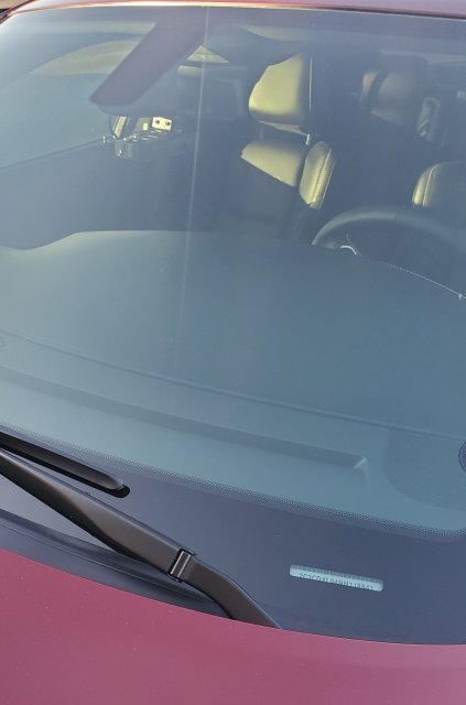

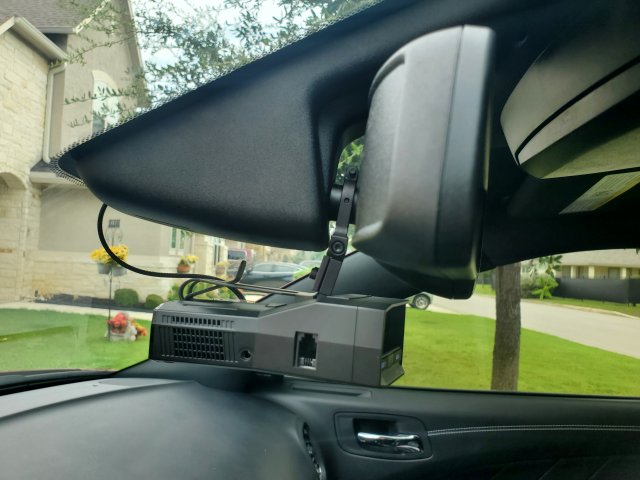

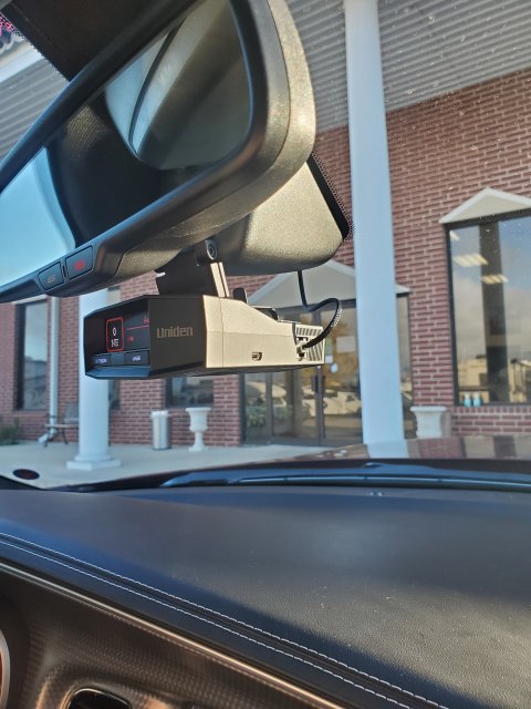

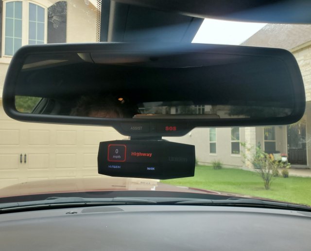

Last week I mounted a Uniden r8 with a Blendmount (BR7-200R) and a Blendmount mirror tap kit (MTX-1045). It came out pretty good me thinks.
I was concerned that it may be a distraction or have me rubber necking to see around the blind spots, it's a large detector. Luckily, after removing the additional link on the mount, it tucked up fairly tight under the mirror and doesn't cause me any blind spot grief.
It's a straight forward install but I'll share this. I had to us magnifiers to get the tap blades into the harness correctly. Tiny wires and a very small harness. On mine, it had three wires, orange with pink stripe, solid pink and black. Solid pink was hot when the ignition was on and cold with it off. Black was the ground.

Looks clean, I've not seen an R8 in person & had no idea they were that large !

Thanks! I'm happy with it. It's a big mama but looks decent in a big car I guess lol... It does look larger in the pics I believe.

It's pretty quick to release the clip, unplug and remove with this set-up. I told myself that I would remove it when parked. Alas, the gambler in me seems to win out every time and there it stays.
