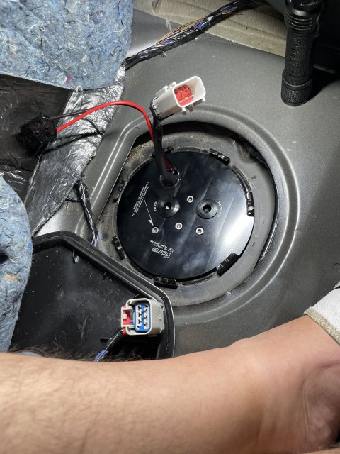

Installed the OST Dyno dual fuel pump kit. Extremely pleased.
Full kit on the bench.
Had too much in the tank, used a transfer pump and an empty jug.
I hate this thing, especially the stupid effing thumb press latch, it can suck a fat D...
It's in (that's what she said!!!!!).

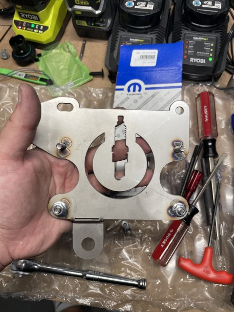

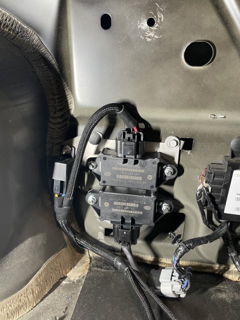

This bracket alone is worth it, sadly it will be covered up!

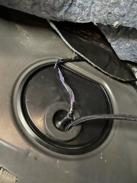

Love the bracket. Ran the harnesses along the other body harnesses to make it look factory.
Put a hole in the gromet and it cleaned up well.

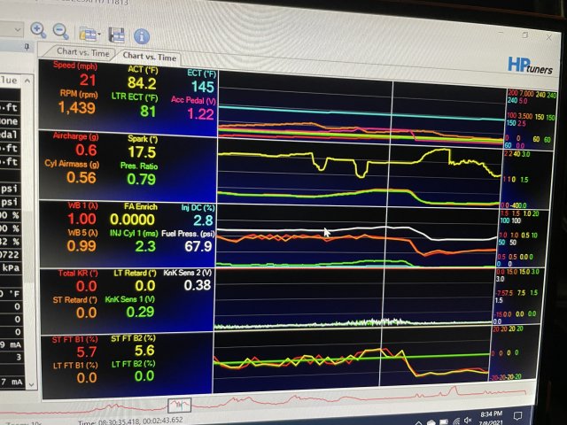

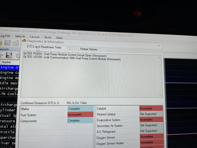

Got two error codes on first start, cleared them and started the car.
60PSI on idle and rose when I started to accelerate. Fully expecting around 79-80 PSI on WOT.
Tomorrow is test and tune, that will be the real trial!

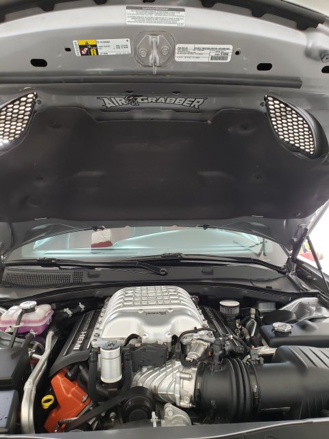

Ever think of driving around with the firewall cowl panel off? Or the brace also? When I did my pulley swap I took everything off to lift the blower, I left the panel and brace off on a test drive. It's gotta help on heat removal and it looks really cool when driving. You can see the blower full time! I don't really drive it in bad weather anyway and if I get caught in a rainstorm all connections are weather tight, I don't think it would hurt a thing. I'm seriously thinking of taking it off permanently.

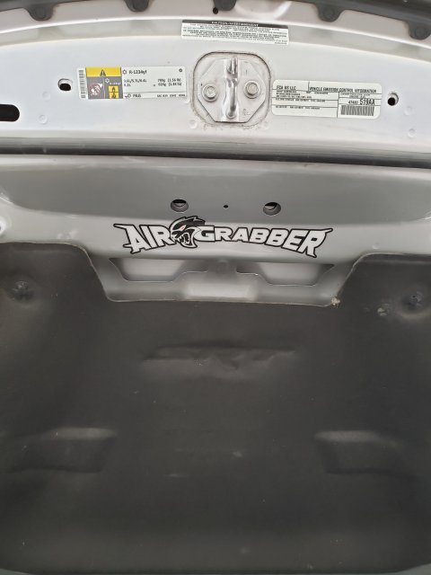

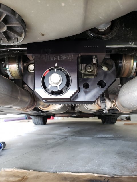

Instilled the DIRS brace (write up in drag racing forum) and installed another racing sticker from @swatdocsc
